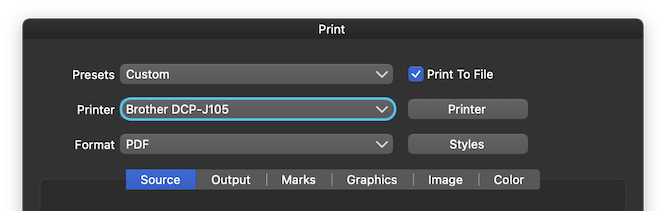

@Victor-Vector Confirmed here. As a workaround for now, you can use the 'Print to File' option (select your printer's engine) from the Print dialog (File > Print).

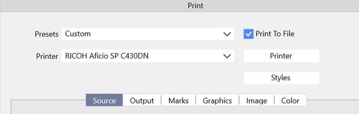

@b77
I am on Windows 11, btw.
I don't seem to have the format drop down option like you do. When I click print, the file extension is .PS (postscript) with no .PDF options like you have. The file only prints as a small .PS file. -
