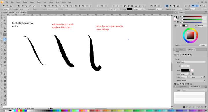

      I don't know if this is a bug or intended behaviour
      Example , brush stroke with narrow profile , when then adjusting a part of the line with the brush width tool , newly created strokes have adopted these new settings , iow overriden the brush stroke setting .
      This is really an annoyance

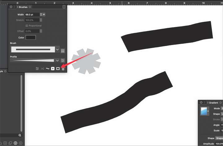

            There is a "solid stroke" button in both the Brushes and Stroke panel (second last in the icon row).
