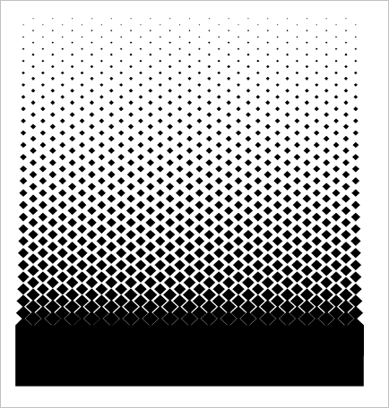

          @vectoradmin Great! I think that bug has contributed to my layers systems getting clogged up and disorganized because pasting a something like this (see below) and having it break the grouping and become a million sublayers can get confusing! It will be nice for groups to be honored between open files. thanks!
