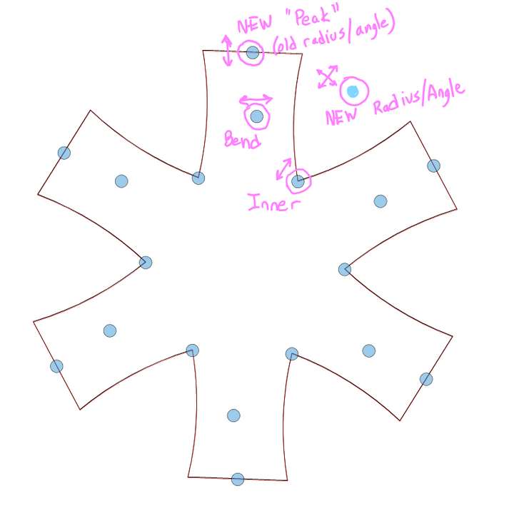

  • @Subpath I like your idea and I see value in adding this function.
    Here's an interface suggestion to make your idea easily editable:
    Of course the Shape Panel would need to be updated as well.

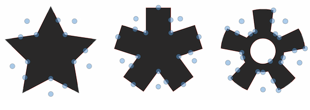

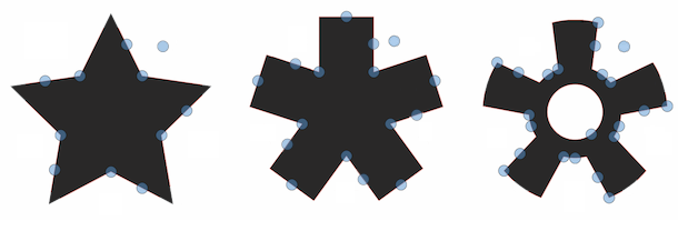

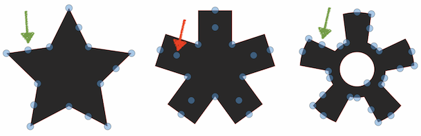

  • I thought about all this, and things might not be that simple.
    First, an observation:
    The bending knob of the Square Star shape is positioned between the two segments it bends, which is different from the Star and Gear shapes, where it is positioned on the segments:
    Unless there is some good reason for this being in the middle, I would move it also on the segment — it makes more sense IMO.
    Anyway, I made a mockup to see how the star-based shapes would look with the scaling knobs positioned between the rays:
    What I'm afraid is that these knobs can be less visible if there are other objects in the background.
    The way half of each knob overlaps the shape now avoids this.
    And… it all looks a bit busy. Maybe use just one knob for scaling?

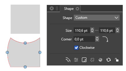

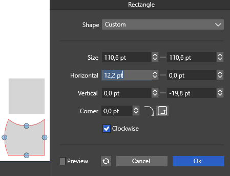

  • @vectoradmin
    I always use the Shape Panel to change the count
    and also to reset the Bend.
    But the Bend in the Rectangle/Square shape
    doesnt have an Option to do that.
    Only the Rectangle Option have this

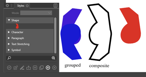

  • @vectoradmin
    thank you for the explanation.
    Could you briefly explain how I then pass this "style" to other objects ?
    I think I figured out how to do this.
    Select Panels > Styles > Styles (alt+v).
    Open Shape in the panel and here is your previously
    created Shape role
    Select the object(s) you want to apply it to and press the icon in the bottom
    left corner. To test it, just scale your original object
    Did some tests:
    Node editing is possible
    Group shapes after you applied the style too
    Even composite objects work (not possible with clone)
    but give me a fixable strange position for an object inside the composite object
    will explore this further
    Video: here my results
    @Subpath When an object is selected, the Shape panel (and the Context panel) will contain a "Shape" drop down, that lists all the Shape styles and presets.
    Select the shape from there. The shape is listed with the name that was assigned to the object with the Shape role.
    @Subpath Yes, the Styles panel also works for this.
