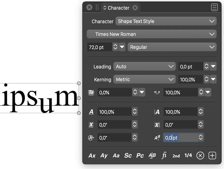

 attempting to adjust the leading of one character to sit below baseline. no response to input in character panel. character will not move up or down?

 @electroplated To offset a character baseline, use the baseline offset option in the Character panel lowest row right numeric field.  I checked and the default setting for text greeking is 8 screen pixels (set in the View -> Display -> Display Options). This will of course depend on both zooming and font size.

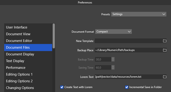

 Yes there is the little critter I was searching for, hiding in plain sight, thanks. I have to say I continue to be bamboozled by the interface and controls. I drew a text box and could not find a way to precisely size and position it and the odd greeking still exists, persists and the box was filled with placeholder text that I could not delete? I'm just used to AI and looking for a less expensive alternative to produce print related business stationery, posters, flyers etc. I appreciate how capable this app is but maybe just not a typographers dream
 @electroplated Default greeking should be smaller in the new build. To precisely size a text frame (or any object), use the Transform panel, just like in AI

 You can define your own default Placeholder Lorem Text in the Preferences. Or switch off the default Placeholder Text Content by uncheck "Create Text with Lorem"
 very helpful, thanks. that's what I needed to know
