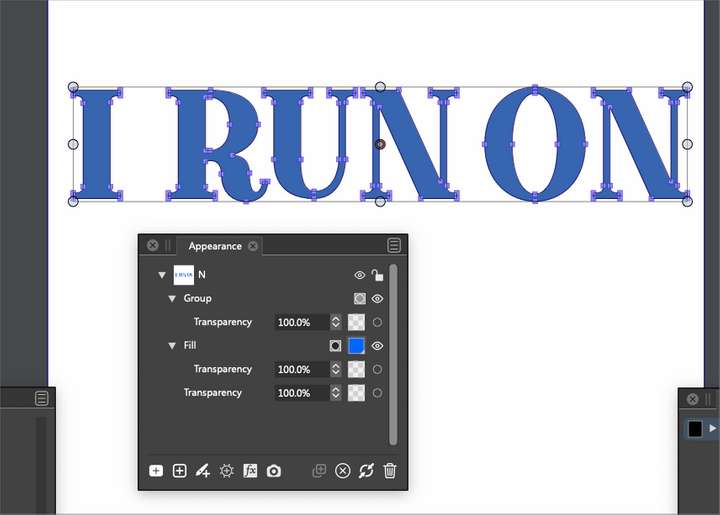

      I am working with some expanded text and it seems to have a stroke attached to it that cannot be removed... I don't know if it's related to it being a compound path
      0_1652812196980_test6.vstyler
      0_1652812705927_d1b343ad-0301-4451-8af6-f330c88741a9-BLD 2022-05-17 at 14.37.58.png
        b77 @Boldline
        @Boldline Maybe it has two strokes? Check the Appearance panel, or post the file here.
          Boldline @b77
          @b77 file is posted - the link is right above the image. is there a better spot I should put the link?
          I did check the appearance panel and I did not see any strokes listed there

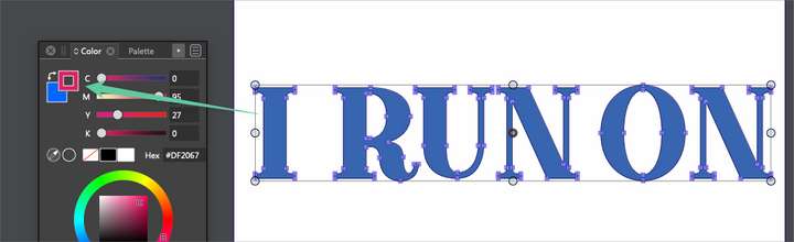

          0_1652813691164_3f50e699-626a-4086-bbda-699b8dda756a-BLD 2022-05-17 at 14.54.27.png
            @Boldline At least here, this seems to be a clipping group, containing some red outlines also.
              b77 @Boldline
              @Boldline Sorry, too much blue from the video link above and I didn't see it. 🙂
              Strange. Once you change the stroke width to something else, a stroke attribute is assigned and changing its color works as it should.
                @VectorStyler said in Cannot get rid of stroke and it changes color in odd ways in the color panel:
                interesting - I was going to clip it next but had not done so yet - just made it a combined shape
