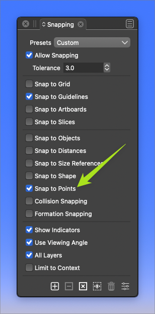

I opened the panel through the panels window and checked "snap to points" and that is essentially giving me what I need. Is this the best way to do this? Even then I'm finding it's hit or miss - when i click on the last node - sometimes it makes a cusp, other times it ends the path line...
