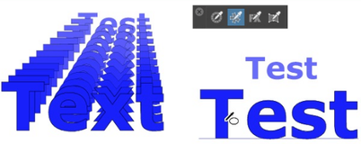

I have this simple effect which uses 2 words, repeated 3 times on different layers/groups.
Is there an option to change the text once? Some variables I don't know yet?
Otherwise I have to change that 3 times.

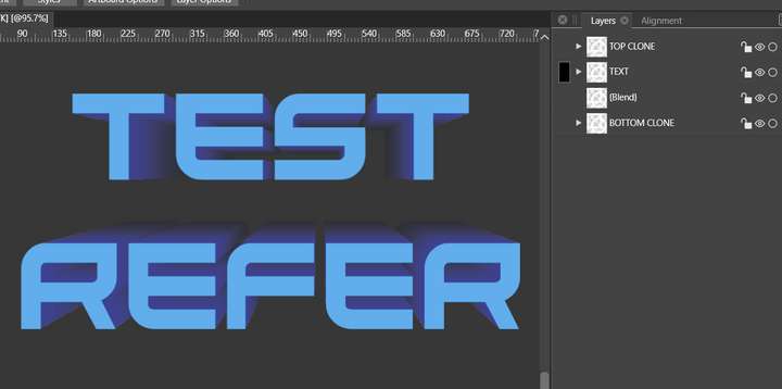

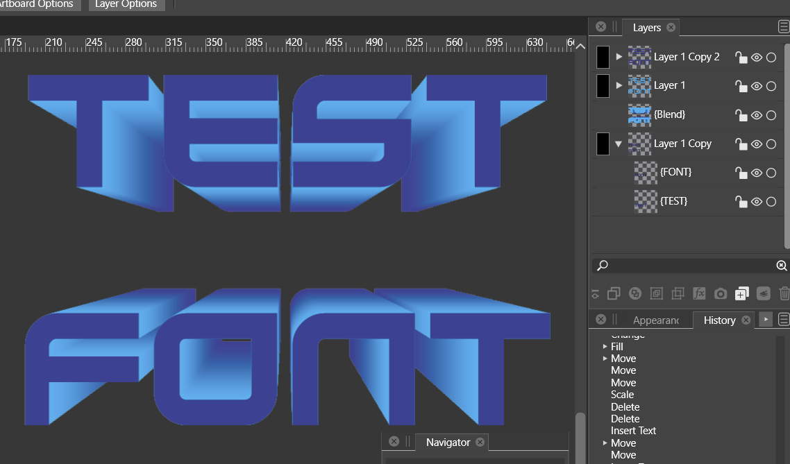

I found there are those References and Clones, Clones are great, but VS keeps crashing while using it
@plrang do you need references and clones for what you were doing (I saw your original screen shot)? I've made similar things without
Keeps crashing while I'm trying to make some simple changes, like the CLONE color or TEXT color etc. Impossible to work with that.

Yes I sent 1 report, the crash repeated just with the described operation.Cloning is cool but unfortunately Blend doesn't seem to consider clones or references, references don't consider changing object parameters, like colors.
And cloned groups of text don't seem to pass on text changes. But I can't test that because the program crashes all the time.
