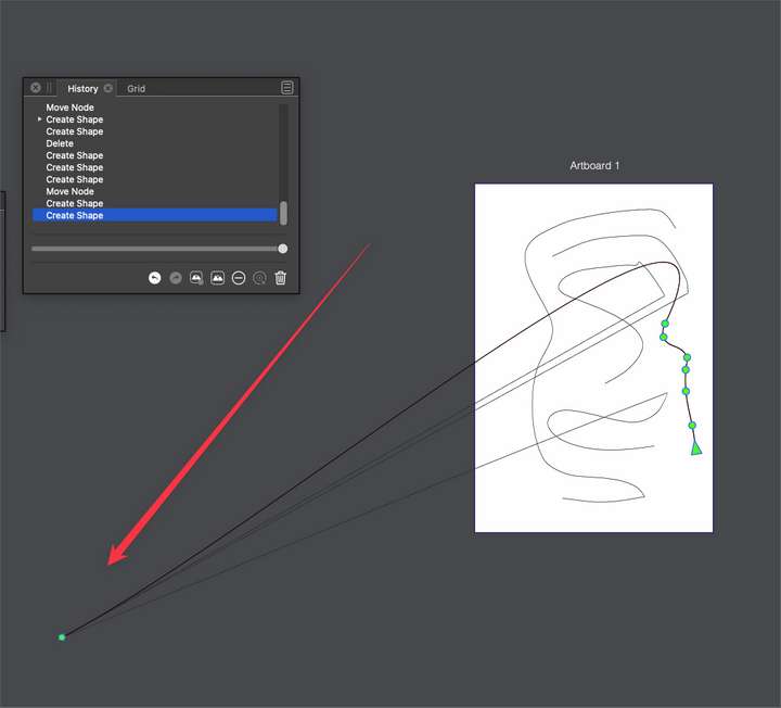

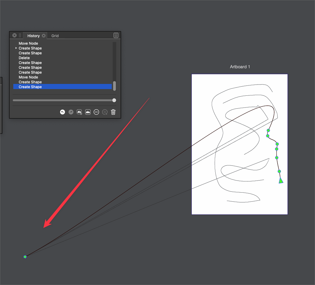

I noticed if I made a stroke using the pencil and let go and then pressed down the command key, I could edit the pencil path immediately - this was good and expected... if I was using the pencil tool and making a path and then pressed and held down the command key before releasing the pencil tool with a click of the cursor, it sent the pencil path off to the far left side of the screen - off the artboard. Here is the video for that
0_1658237131253_pencil command key.vstyler
This is an obscure thing and results from a misuse of the modifier tool, but since I ran into it and could reproduce it, I wanted to at least bring it up in the forum
@Boldline Replicated, will be fixed ASAP.

@Boldline I think in this case the issue is that the Command key was configured to draw lines, and drawing lines with the Rope stabilizer has a bug.
