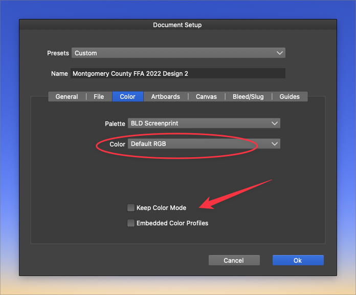

            @VectorStyler Would these settings play a role in the issue in this case? Prior to doing the project I had switched an earlier project over to RGB mode. When I went to make the next new file it retained the RGB setting instead of the CMYK I typically use
            0_1662736188794_31a0acf5-39b8-499e-b912-cbd38f80d47f-BLD 2022-09-09 at 11.08.13.png
              @Boldline Not these should not affect the palette color addition.

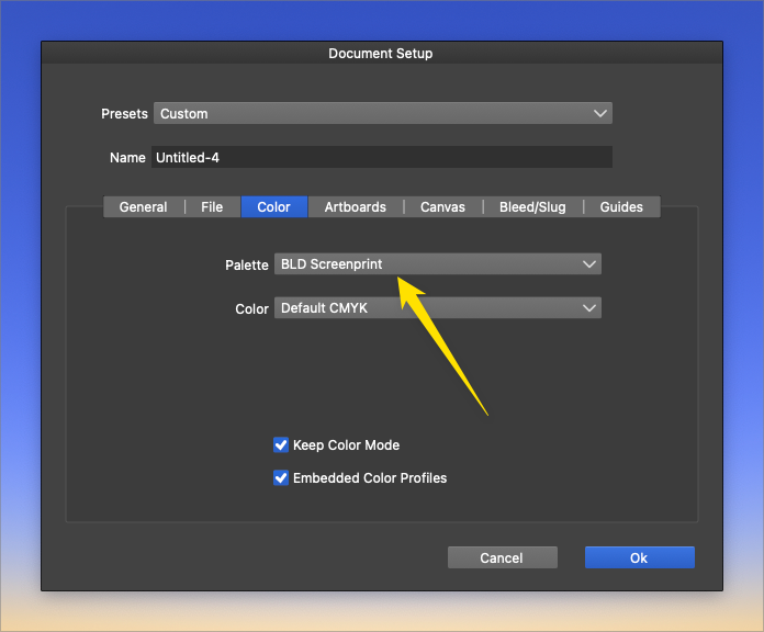

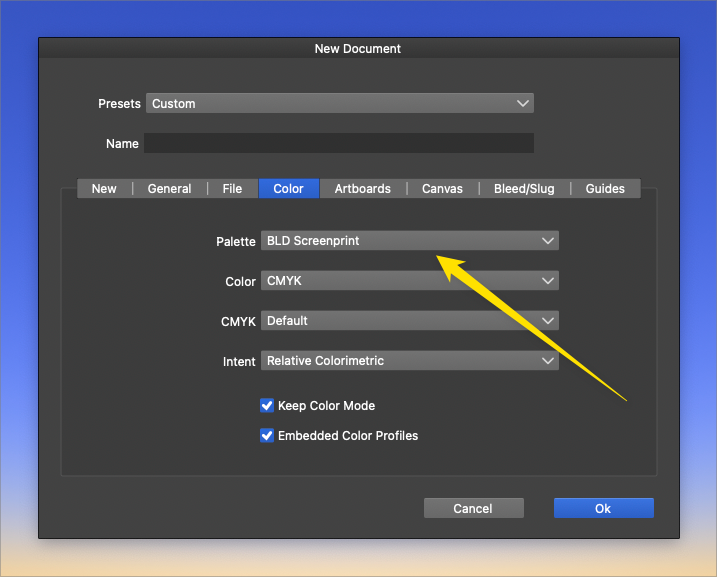

                In the meantime, I went in and made a new file entirely and checked the settings for a "new document setup" and my color profile there is named "BLD Screenprint" as it should be.... then when I commit to that setting and the new file opens, I check the color palette bar to see what color palette name it has - it's the same one- "BLD Screenprint"
                I also checked the "document setup" after creating the file to see if anything changed in the color palette name installed there - but it all looked correct.

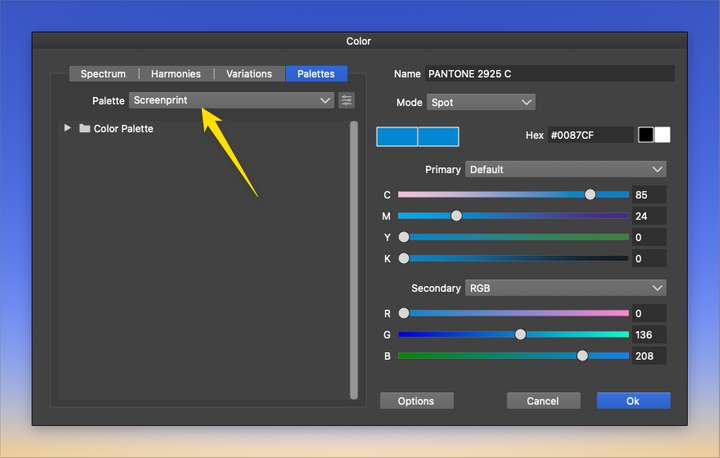

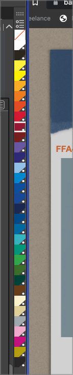

                If I click on a color from the vertical toolbar and use it in the design, it adds it to the main palette as a new color. If I then double click on the color palette bar color, it displays the color panel and the palette name is called "screenprint", which is a different color palette.... but when I hover over the color palette bar, it tells me the name is "BLD Screenprint", which is what I want it to be. (cursor is not showing in the image below but is there in real life)
                To my untrained eye, it appears the vertical tool palette bar is telling me it's the right palette installed when I hover over it to get the name, but when I double-click on a color in that palette bar, it tells me another and I am guessing the hover tooltip name is not accurate?

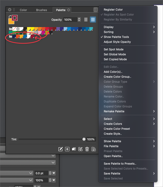

                  Enable "Register by Similarity" in the palette panel menu, to compare the color (not the name) when adding to the palette.
                    @VectorStyler ok thanks - that helped a lot actually. Now when I click on a color in the color palette bar, it corresponds with the same color being selected in the main color palette I installed as the file default!

                      @VectorStyler Is there still a discrepancy issue with the name of the color palette file installed in the color palette bar? Why would it say the name of a different color palette file when I double-click and open a color compared to hovering over the top of the same color palette bar and getting a different name there in the tool-tip popup? Should this concern me?

                        They are just labels, so no concern.
                        I think this is just the name of the palette, and in the first case it uses the file name, the second the palette name stored inside the palette.
                        I have to look into this to have them the same.
