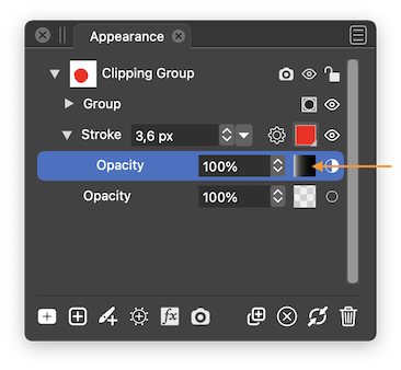

@VectorWhiz You can use a gradient mask for the opacity of the blurred stroke of the container object so it's visible only on the lower left side:

@VectorWhiz The technique you describe here is good — nothing against it — but the problem is that the
blurred stroke of the container object on Artboard 3 remains visible in the upper right side of the shape against
the white of the artboard, and I guess most of the time you don't want that.My suggestion is an improvement to the method you described and if you download the attached file
you can see in the Appearance panel the gradient masking applied to the opacity of that blurred stroke, which
makes it transparent in the upper right area:
This is the file: 0_1667086031503_modified.vstyler
