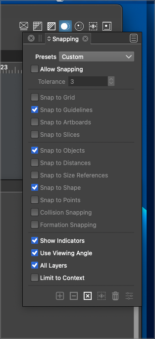

Not easy to activate the snapping options icon to adjust settings
It might be something I am doing wrong, but I usually cannot access the snapping settings through the snapping icon at the upper right corner of VS. Sometimes after numerous click attempts, the menu will open up.

@b77 I think I figured it out. If I move the entire VS UI over to the left a little bit, the icon works correctly and displays the snapping options list. If I put it back in its natural position filling the screen, it does not work again. I wonder if it needs a certain amount of space to display and it's not getting that when VS fills the screen
Interesting⦠could be that the hit area is slightly shorter than the width of your screen.

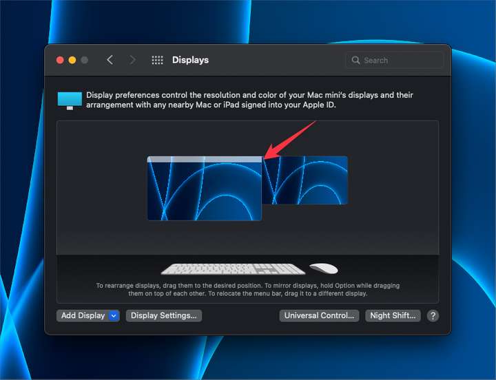

I use my wacom cintiq as my primary monitor and then have a secondary standard monitor attached as well. Even though in real life, I have them one over the top of the other, in terms of mouse movement, I have them arranged with the secondary monitor accessible to the right side.
So the snapping icon is on the far right corner of my main screen but that also borders the secondary screen. If I move the secondary screen to the left side of the main one instead, the snapping button works as expected.
@Boldline Tried to replicate this with a similar dual screen setup on a Mac Mini M1, but it seems to be working here.

I was trying this again now with the 71 build release and still running into the same issue with the snapping icon not opening the menu below on the main screen. when I pull the VS UI over, it works fine as it should. I noticed there's an overlap off the right side of the UI where the snapping panel opens beyond the UI - could this be causing the issue? what if the panel opened flush with the UI?
