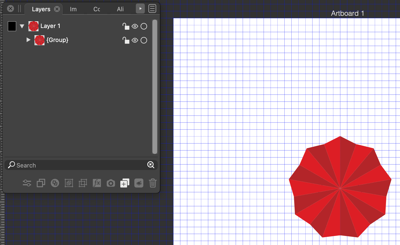

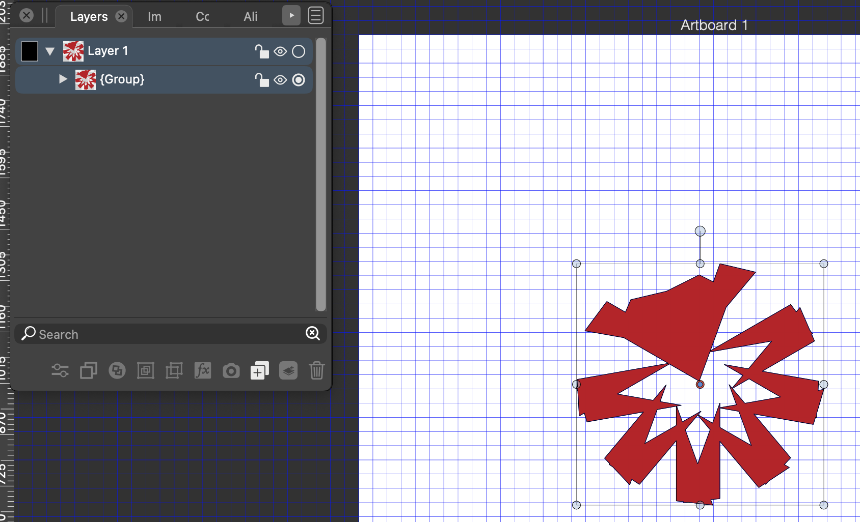

if i select the group in attached file, and press merge the result is very strange.
100% reproducible at my side.

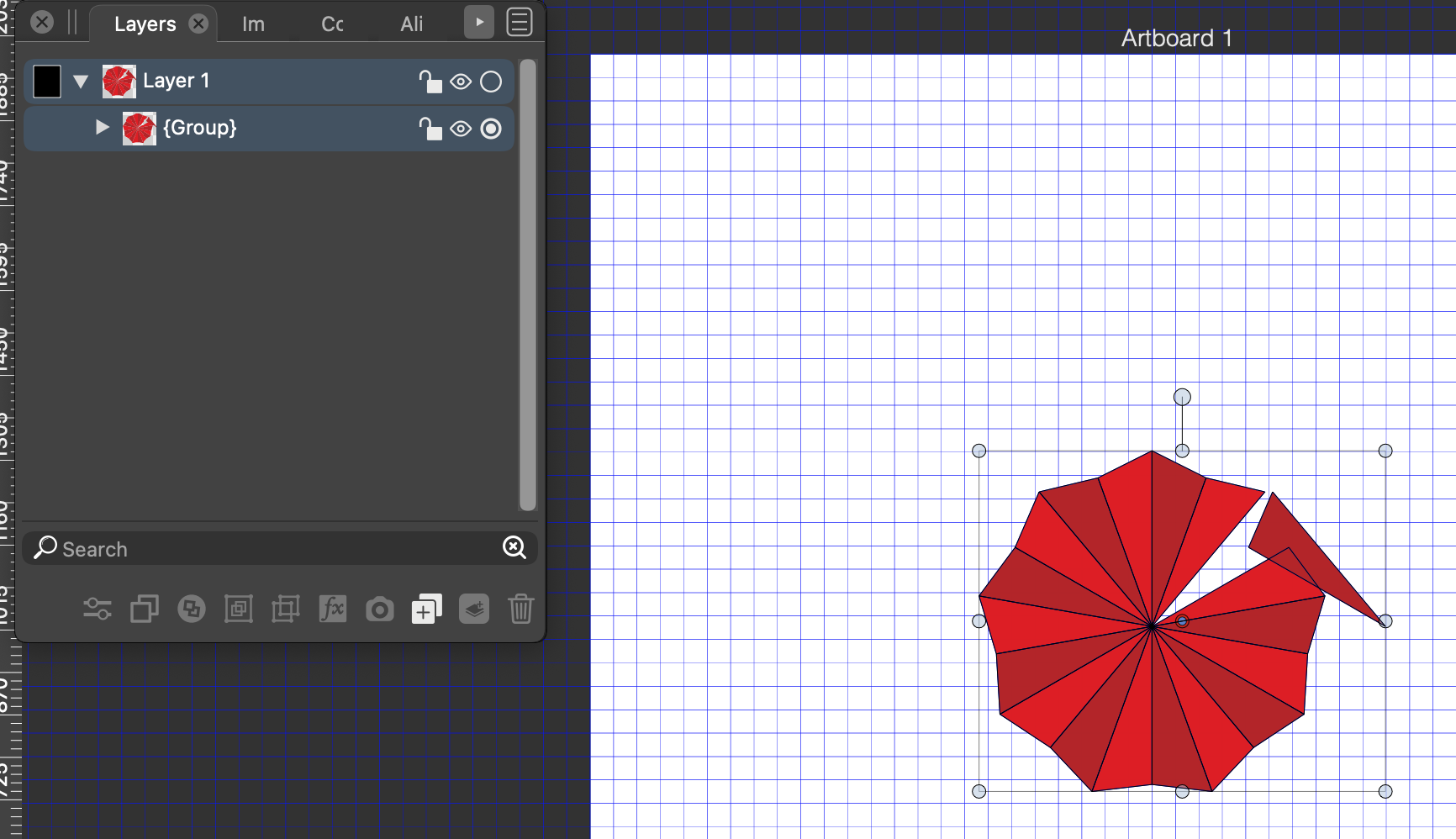

If I press in that situation undo, the result is not as expected too. One element is not at the correct position.

@MajorTom yes, can be replicated here also.
There seems to be a bug in how the transformations are expanded, also breaks the convert to curve operation.
Will be fixed ASAP.Workaround: ungroup first and then merge.
