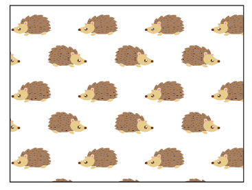

    Important Note about using nested groups.
    Creating a seamless pattern with nested groups could cause
    several problems if you clone them like here.
    For cloning and positioning, you could take stylized objects
    and then replace them with the original before cutting.
    Or you could try to use the "Tiling Pattern Content" role. How
    to do this is described in the manual.

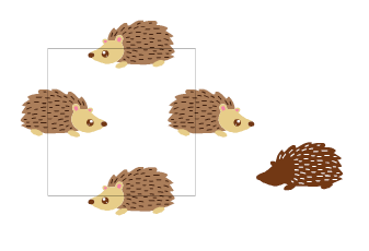

    Here some Pictures and a Pattern Result
    Cutting Scheme and Stylize Shape
    combined shapes
    Pattern Template for the Preset after cutting
    the pattern

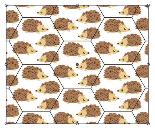

  • @fewerjunk
    This pattern was created using the "Pattern Tiling Content" Role
    which is easier to do than the method I show in my tutorial above.
    I used the Hex Grid, the outline could be disabled

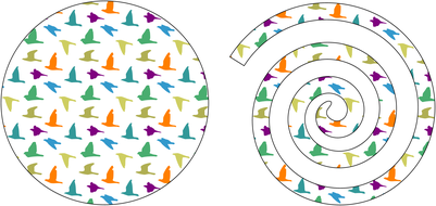

  • Here's what I got for my efforts:
  • This doesn't appear to "just work". Working depends on what you do and how you do it which varies depending on what you're trying to do. Procedurally this seems to work a lot easier, but with fewer options and more effort.
    Programmatically, this isn't working for me. It could be something I'm doing or not doing or not understanding. Or it could be the program. Or some combination of the two.
    I like what VectorStyler is trying to do. It's the trying to do it that's causing me problems.
