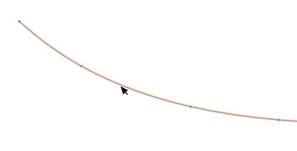

Dont know if seeing the regular Nodes too
would irritate users.But i second the Wish from @Pat, was in the same need
to see the regular Nodes with the Width Nodes and though
that this would be useful.I think the way the Nodes are shown when i hoover
with the Transform Tool over a Curve would be enough for me.
Here a Picture
