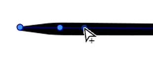

Set new Width Nodes Indicator Idea
When I tried out how the Width Nodes now work in the new version.
Came to me the idea that maybe indicator would be quite helpful,
showing when it is possible to set a new width node.
Because it is a kind of trial and error.Maybe a small + sign could give a hint when it should
be possible to set a new width node. But i am open for other ideas.

I just like to say how much I appreciate the little + sign
that now indicates when it is possible to set a Width Nodemuch more better than before
