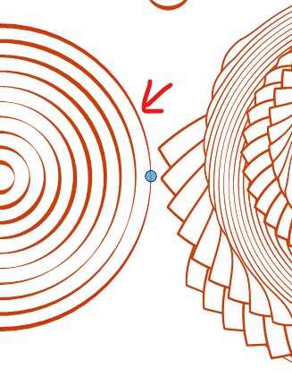

I wanted to copy a circle (parametric shape) as a whole:
That copy and paste problem occurs only with Smart Shapes
because the Shape Object cannot be selected with
the Shape Editor Tool.
But you still have two options herefirst one
While have the smart shape and the Shape Editor tool selected.
Press and hold down the CTRL-Key + the ALT-key.Then drag the Shape a little distance, while holding the left Mousebutton down.
This will create a copy of the smart shape object.
second one
While have the smart shape and the Shape Editor tool are selected.The smart shape will also be shown as selected in the layer panel.
Hold down the Alt-Key and in the Layer Panel grap your
smart Shape Object with the left Mousebutton, drag it below
and a copy of it will be created
