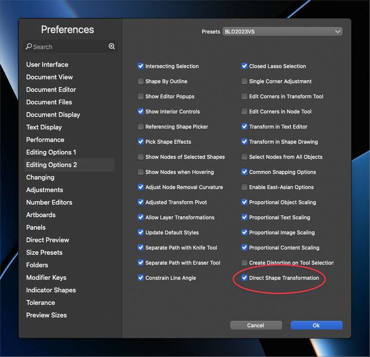

              @Boldline Is "Direct Shape Transformation" enabled in Preferences ?
                @VectorStyler said in Scaling live text still causes font size discrepancies:
                yes it is - should it not be?
                0_1688131798440_4f9923a4-9926-4004-8695-7bad7ac079bd-BLD 2023-06-30 at 09.29.32.png
                  @Boldline said in Scaling live text still causes font size discrepancies:
                  It should be checked. I will test with the attached file.
