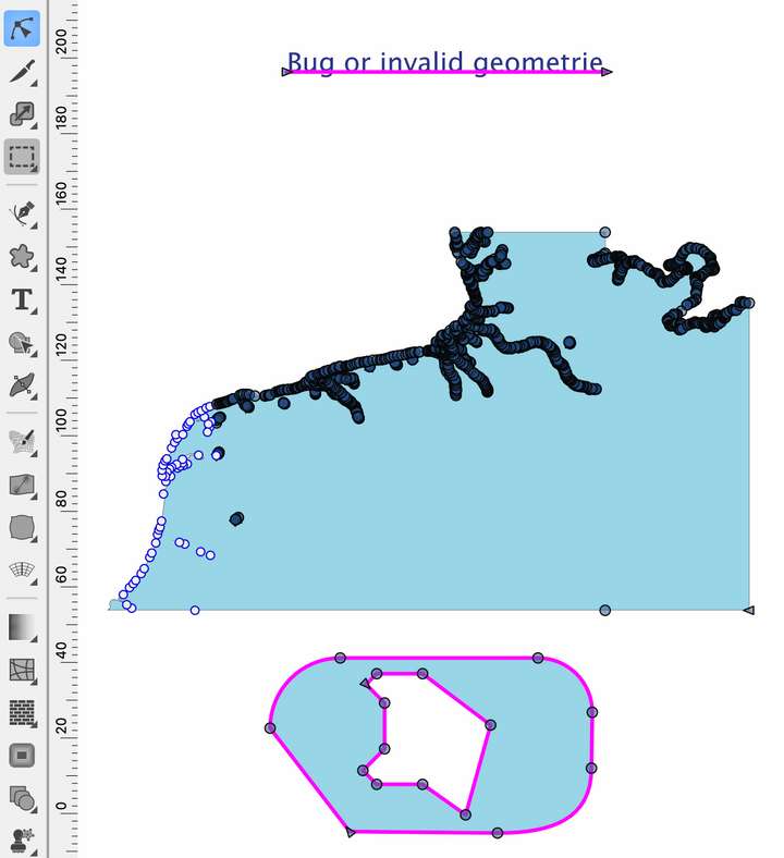

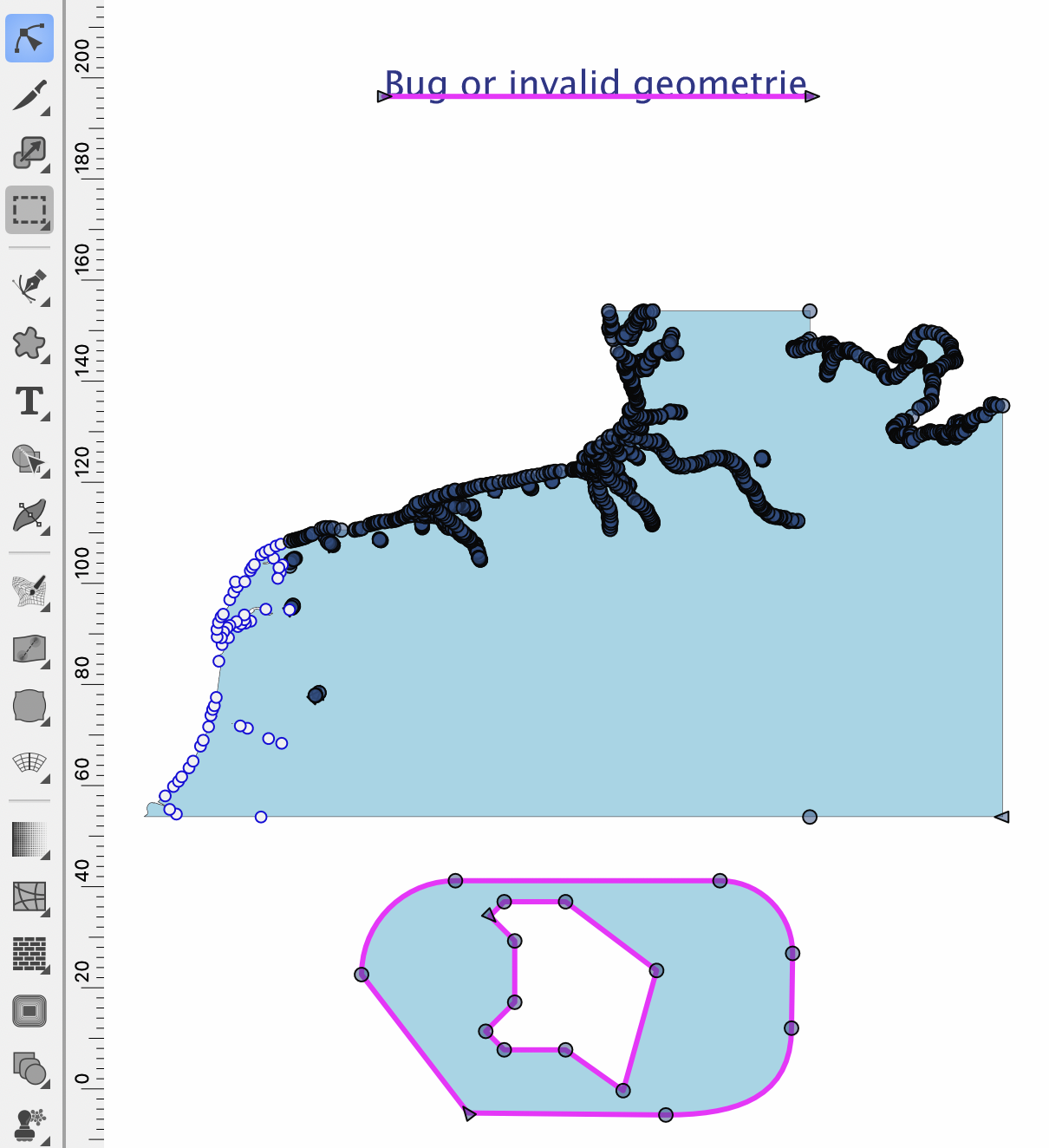

Encountered a strange thing while checking the latest VS release. The Node Editing Outline do not show up at a more complex form.
Setup: all in one layer, shape editor tool enabled and three objects selected.
- new made Shape Text
 - imported more or less complex country form (compound p.)
 - new made fancy test shape (compound p.)
Node Editing Outline exaggerated pinky

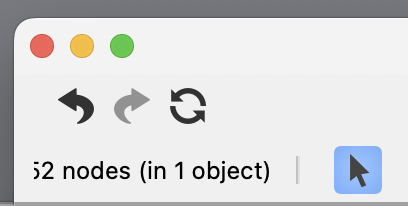

Found out that the visibility threshold is 513 nodes.
512 = visible
513 = invisibleNode info readout window is to small if number exceeds 1 digit.
Did my measurement in PathScribe.
@Ayo Yes, there is a threshold for outline visibility.
I will fix the node readout widget width.
@VectorStyler said in Bug or invalid geometrie:
Will that change in the future or will it stay?
@Ayo said in Bug or invalid geometrie:
It will stay for showing the nodes, but the outline should be visible.
Good to hear, a relief.
Nodes threshold might be a setting. Does what is workable depend on the processor/ram memory on the user side?
I avoided adding this as a settings, but it is configurable yes (but not by the user).
Yes it depends on what the user computer can handle. These nodes are drawn using cocoa apis on MacOS, and that can be very slow.
