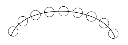

      Align a circle along a path and you get something like this

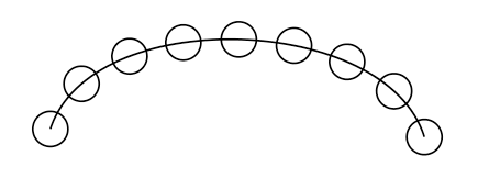

      But what if you want a result like this
      Shure there are ways to get such a result. I like to show how you
      could solve this with Clones.
      Here is the video that shows the necessary steps, re-load
      We need:
      a circle
      a short stroke
      Shape Picker Tool
      Menu > Transfom > Move
      Create the following:
      a curved Path
      a little circle.
      create the short stroke from top to bottom
      (top to bottom is needed because of how alignment works)
      Now select the short Stroke, go to Object > Transform > Move
      and create 8 clones of it. Move them a bit to have some space
      to select them. Select only the clones.
      Call the Alignment Panel
      With your Clones selected select also your Curve.
      Select now "Align the the selected Objects to the Key Object"
      at the Alignment Panel. The Key Object should be the curve Path.
      and the cloned Strokes will be aligned along the Curve
      Select the original of the short Stroke then select the Shape Picker Tool
      and pick the Circle with it.
      Voila, the cloned Strokes are replaced with Circles and the Circles are aligned
      along the Curves how you want them to be.
      Btw, you could use other Shapes too, with this Trick.
