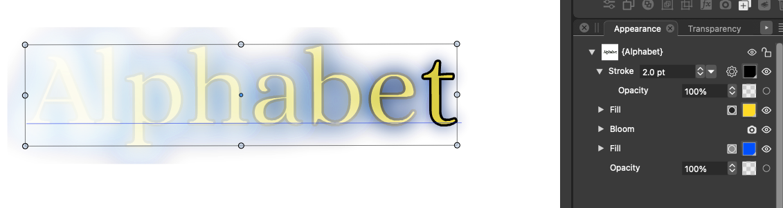

Appearance Out of Order?
It seems the stroke which has 100% capacity is impacted by the Bloom FX which is below it in the Appearance panel?
That doesn't seem right to me.
@fde101 Can you upload that example as a vstyler file?
It seems if you convert the text to curves, the FX will work correctly. But yes, I noticed as if the FX would gradually "fade out" towards the right in case of a live text.
@VectorStyler 0_1692444757710_Alphabet.vstyler
I have also discovered that it does not export to PDF correctly. I do get the effect if I export to PNG, but if I export to PDF, I only get the yellow fill and the stroke, even if I choose the "Vector Text" option.
Rasterizing does not seem to help, but a "Convert To Curves" operation gives me something closer to what I would have expected.
