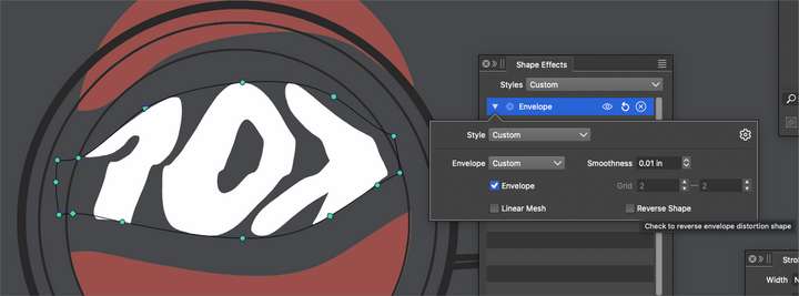

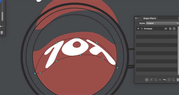

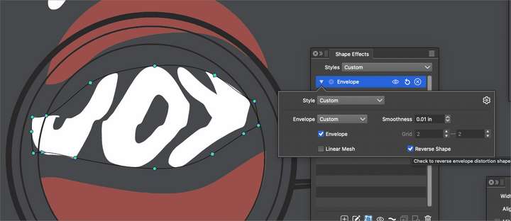

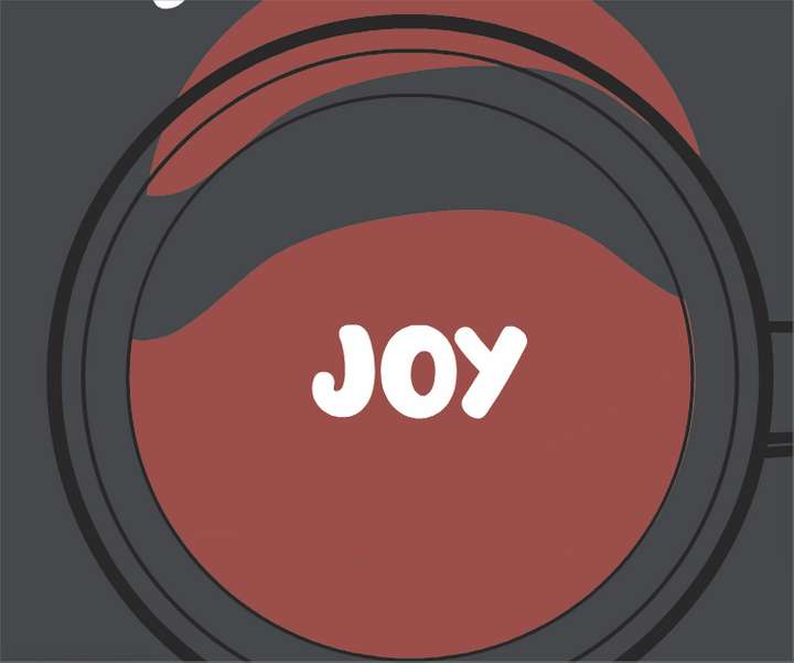

    Is there a reason the word shape flips upside down each time I add an envelope to it and/or add a shape to that? I started with "Joy" and then adding the envelope to it made it go upside down. Adding the shape to it and then reversing it worked

    @Boldline Reverse the direction of the shape. And setting the first not (right click on shape node -> make first..) might also help.
