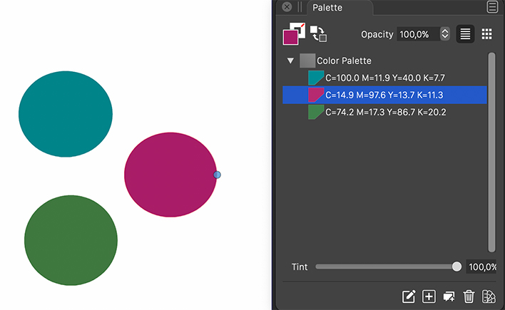

a) This is what I have in the document (three ellipses in CMYK mode and colors assigned with process swatches; the assignment shows so that when I select an object, its color assignment is reflected in the palette):

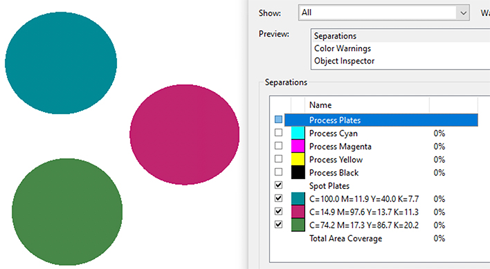

b) When I export a CMYK PDF from this document, this is what I get:
@Arde Yep, the palette colors should not be marked by the app as separations (like spot colors are). IIRC, this was working correctly a few months ago when I tested this.
