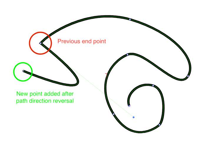

      After reversing a path’s direction( control - I ) on my Mac, then adding a new anchor the resulting segment is extremely bowed and erratic. The control node on the previous end point now has a strange long control arm. It’s necessary to select the previous end point and adjust. Can this be less erratic?0_1696894010614_Reversed end point work.png

            @VectorStyler @b77 If I understand @oleGraf 's post properly, they were asking why when you use the pen tool to add on to the path after first reversing the direction of a path, does it bow out even when making a straight line segment.
            I made a video imitating the scenario @oleGraf presented:

              @oleGraf @Boldline I open a bug on this one.
