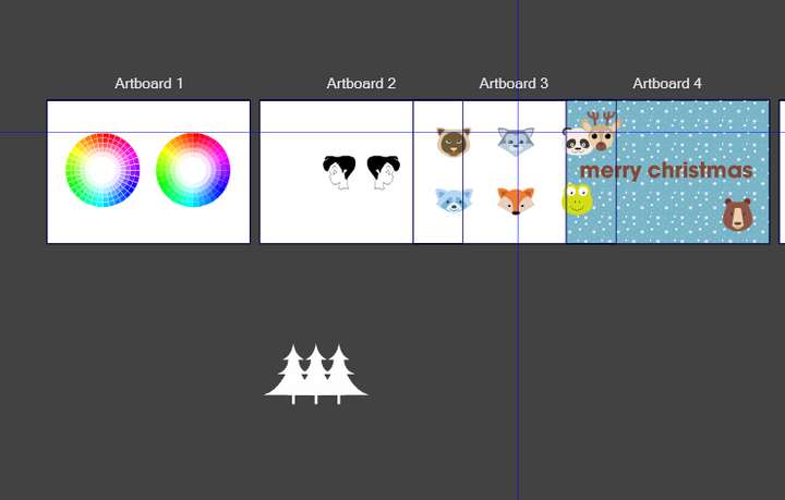

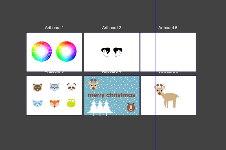

  • When trying to arrange the artboards in the canvas. Artboard 3 + 4 are overlapping other artboads and some objects are not staying in place on the artboards.
    First Image is my starting position. And the other images are from after using arrange artboards

    It does look like something is wrong with the Arrange Artboards feature when there is an image on an artboard.
    I tried creating two artboards in a document and putting simple solid-colored rectangles on both then using Arrange Artboard and it worked quite reasonably.
    I then added an image to one of them and when I tried the feature it created a third artboard alongside them which had a size which didn't seem to correlate to the ones I already had. It also moved the solid-colored rectangle on the artboard with the image to a different location on the artboard.
    Needless to say that is not what I would expect to happen.
