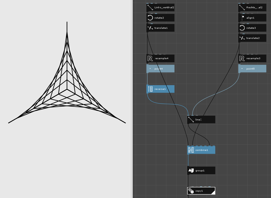

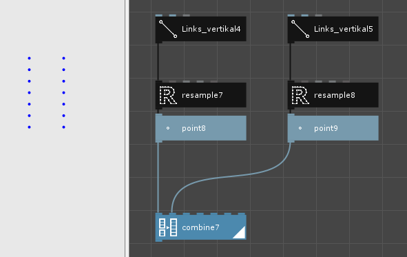

      However, I chose NodeBox for this because it allows me to stay as close as possible
      to the concept of "string art." String art requires nails and a piece of string.
      In VectorStyler, a piece of string can simply be represented by a straight line. Nails, on
      the other hand, cannot be implemented there in the same way they can in NodeBox.

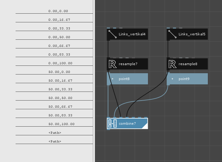

      In NodeBox, there is a "Point" Node for this purpose. This "Point" Node converts vector graphic
      nodes into coordinates. These coordinates can then be passed to a "Line" Node, creating a string
      that runs between two nails/Points.
      All in all, this results in an extremely flexible basic structure that can be used to create a wide variety
      of string art designs. More or less just like in real life.
      Incidentally, the number of Nails can be controlled very easily via the Resample node.
      Nodebox and VectorStyler work together wonderfully. Vector graphics can be easily exchanged
      via the .SVG format—though Nodebox can also export vector graphics as .PDF files.
        Subpath @Subpath
        For anyone who is interested here the Nodebox Nodetree
        for the Base
        and the first structure

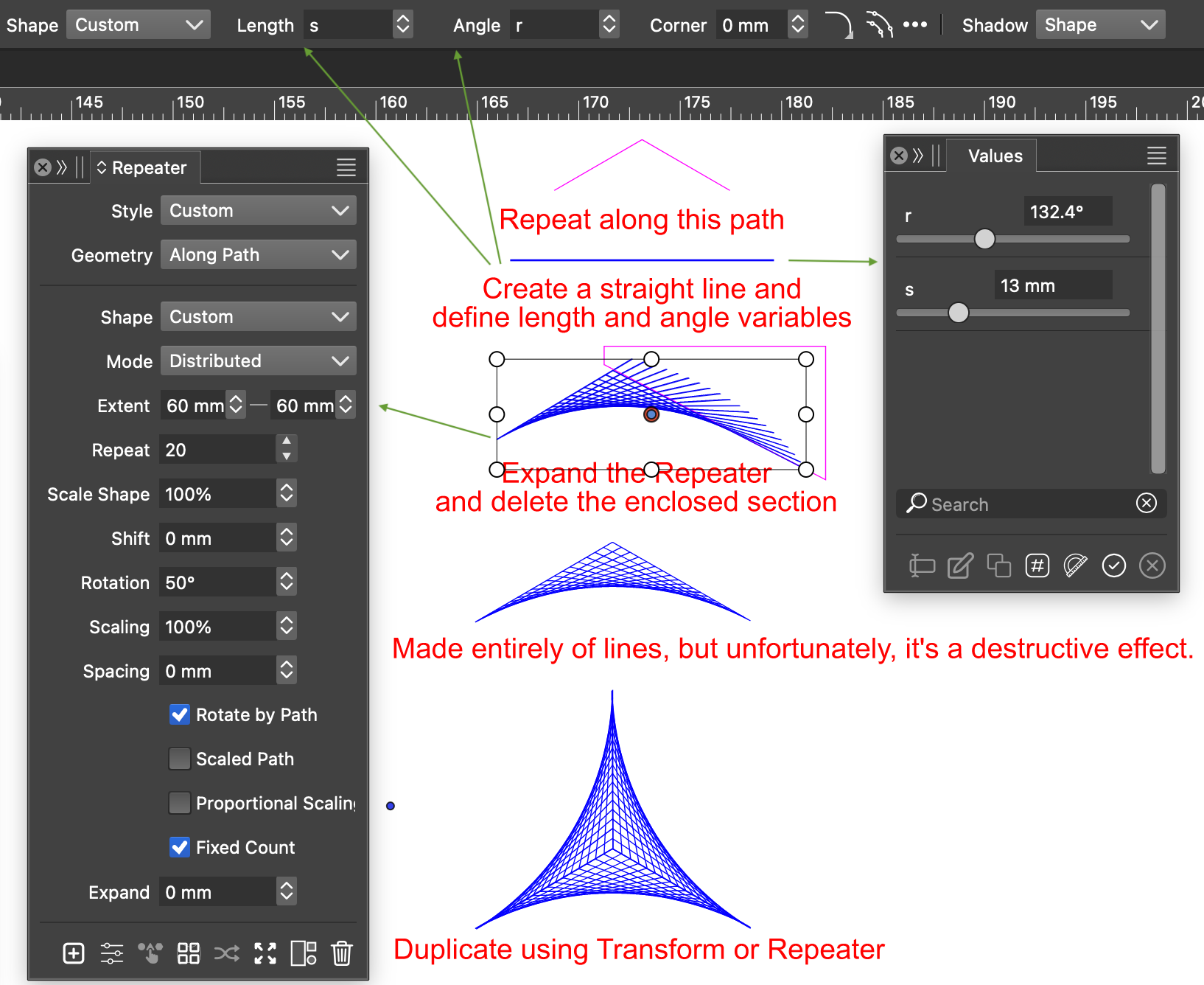

          @Subpath Node-based apps can indeed create some very unique patterns through different node combinations, but combining different tools in VectorStyler is also super versatile! It is possible to build this with lines using the Transform tool or the Repeater, but the drawback is that it cannot remain non-destructive. As a result, making tweaks and adjustments isn't quite as convenient as in node-based workflows. Attached is a screenshot demonstrating the Repeater approach.

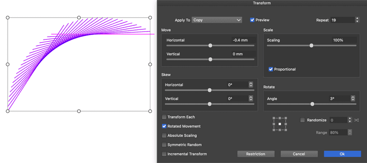

            Li Xiao @Li Xiao
            It can also be done very quickly using Transform, though it's still a destructive effect.

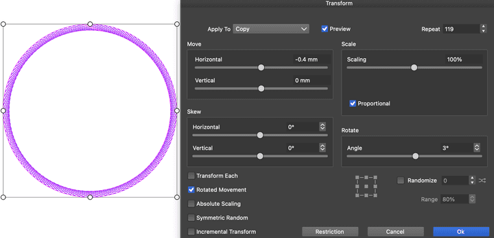

              Li Xiao @Li Xiao
              Generating a circular pattern using the Transform tool is quite straightforward.
