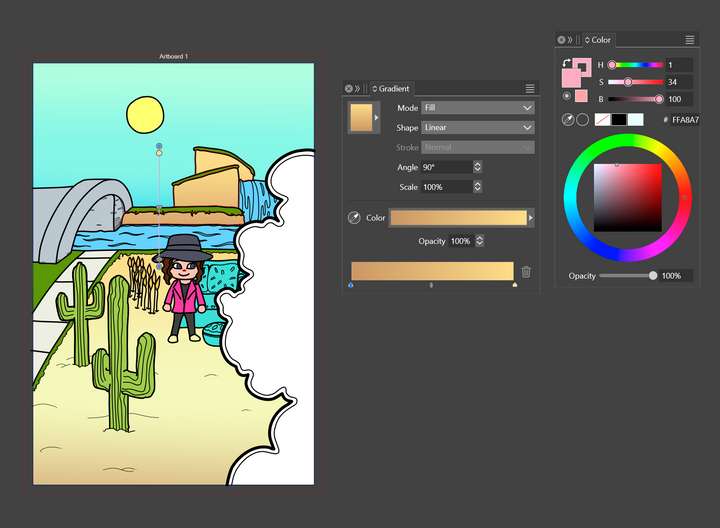

      I had a few bugs to report related to this as I've just started using it, but if it is OK, I made a small video with annotations. I feel like it better shows what is actually going on as I start using different elements of the program and also paints a clearer picture to the kinds of issues I keep running into as far as clickability/usability of various inputs in VS on the Windows side:
      https://1drv.ms/v/s!AuWHX0h5bAoRio9Wa7PuokV4GAbyUw?e=wNX6LA

          In the recording, there seems to be some problems with the double clicks. Are these clicks with the mouse or the tablet?
          • The color selector popup opens with a double click on the gradient knob. Also, when a gradient knob is selected, the (regular) color panel, or palette panel will select colors for that knob.

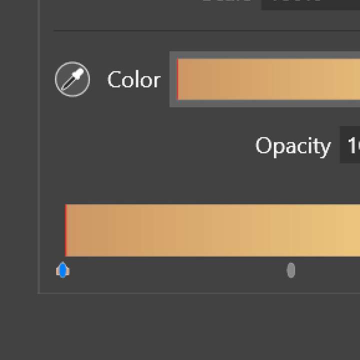

          • Yes, the truncation can be replicate here. I will try to find a fix for this.
          • The gradient editor line (on the canvas) moved because the rotation angle was changed. The line is displayed using the (axial) gradient positions, and these can change based on the rotation.
          • Scale has no meaning for axial gradients.
          • The opacity value is for the selected gradient knob. Overall opacity of the whole object can be set in the Transparency panel (but deselect the knob first).
          • If a numeric field is not fully highlighted, click to activate (shows the cursor) and ctrl+a should select all.
            But it should select the whole text when clicking the field the first time (will deselect on the second click).

            @VectorStyler said in Gradient Editor:
            @debraspicher
            No table usage in this video. To show when pen is/isn't used, I've included a crop of the Wacom Diagnostic panel (Windows PowerToys allows this). If it says "Proximity: Out" and no device showing, it means the pen is not hovering over the tablet or being used. Otherwise it'll show everything being read with the pen, including pressure data. I have 2 I use since one reads barrel rotation and both have a different pressure curve so I alternate.
            Yes, @Subpath clarified this for me. I used both single clicks and double clicks for this and it was triggering the panel very sporadically for double clicks but instantly disappearing. Again, it left the impression I needed to single click as I might've been clicking it away when opened. It was a low success rate to get the fly out panel to stay open at all.
            Good to know it's not just my setup.
            Good to know what is normal, so I appreciate this.
            Yeah, I was trying to adjust the opacity field and clicked that by accident.
            I'm aware of that. I am just surprised that it goes to background instead of to the fill color set for the Object. But that just may be, again, myself misunderstanding how this particular Gradient tool is applied. Looking back I can see it overrides the Fill.
            My own preference is the Fill Color is maintained so when transparency is involved, we are essentially working on top of some sort of matte color. That way we do not have to have duplicates to simulate this. But it's not that big of a deal and there may already be that functionality, I just haven't learned it yet.
            I cannot stress enough how frustrating it is to work with fields at times. The dragging behavior has not helped with that experience and it's something I wish I could disable. If I want to highlight a portion of an integer, sometimes it won't allow working with the caret easily since full activation occasionally glitches out and it's almost like clicks are being misread or delayed. Sometimes I can work an hour or so with little to no issue, but admittedly I'm avoiding excessive data entry wherever possible because of the issues I'm having. It doesn't appear to be tied to anything specific I am doing on the Canvas. Interacting with fields is not easily precise when the misbehavior occurs and hard to explain in clear detail or even capture on video because it's a user experience issue. There is frequently a delay in working with UI elements overall and is palpable wherever I work most of the time, so I suspect that could be helping to "play up" the issue or even impacting how clicks being read/misread. That's only a guess, though.
            Thanks for taking the time to look into this.
