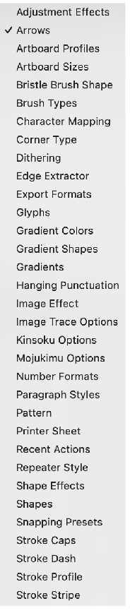

In the Preset Manager menu list:
shouldn't Arrows become Stroke Arrows?See bottom list Stroke family

I will rename the "Arrows" thing.

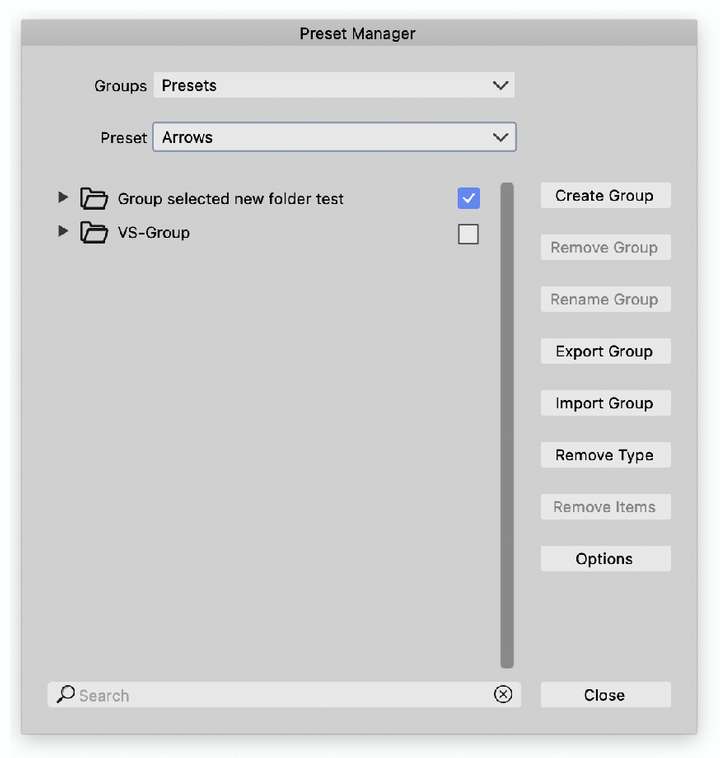

Tried keeping the default arrow set (Export Group) to see if I could delete the group as well.
Did export and get a very long list of all presets? including selected. Is this correct?

Yes, all the presets were copied from that group (exports the whole group).
The Options button opens other exporting options.

I know what a group means, but it's about naming in the menus, panels and documentation to keep things apart. Let me explain...Presets Group n.1
If I say 'Create New Folder' in the Preset Manager menu, I get a popup with 'Create New Group'. The pre-filled text then says 'Group'. You can then complete the name yourself. For example, I create 'Group my Arrows' folder.Presets Group n.2
Button 'Export Group' in the Preset Manager means export the whole group of all the presets. All 51 types that exist, arrows, gradients, patterns etc. Not 'Group my Arrows'This is confusing

@Ayo said in Deactivate preset folder but keep it in sight?:
This should export only the types in the current group. I will open a bug on this to verify it.
