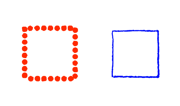

            The two test objects:

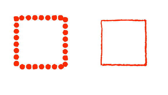

            The result in Alternate Style Picker Mode:

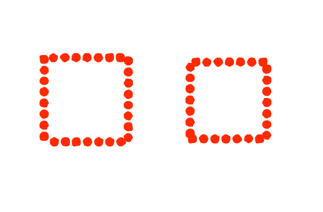

            The Result in Default Style Picker Mode:

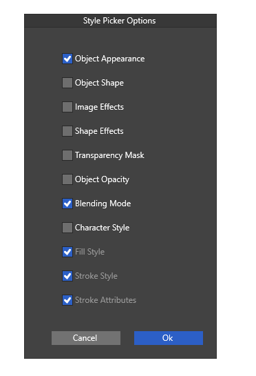

            My style picker settings:

                  Subpath @VectorStyler
                  I'm a bit surprised by the settings in the yellow frame
                  Because you can only set these if "Object Appearance"
                  is deselected
                  So they are inactive, but still selected?
                    VectorStyler @Subpath
                    @Subpath said in Style picker tool not working as epected on windows:
                    Because you can only set these if "Object Appearance" is deselected
                    the "Object Appearance" includes these.
