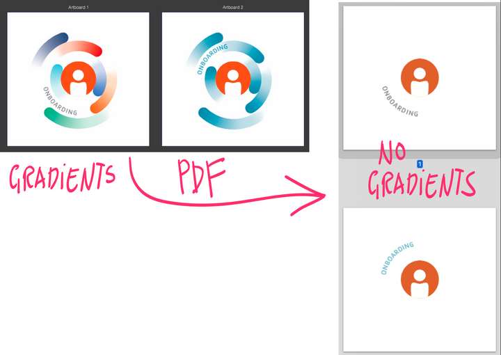

      With reference to former post
      Since latest VS-update eksport to pdf still fails concerning mesh gradients in masks
      0_1727926687767_05.pdf
      0_1727926776464_onboarding-logo-260924.vstyler
        VectorStyler @Raaskot
        @Raaskot said in Updated: Masked mesh gradients --> bad pdf:
        Yes, this is not fixed yet. The problem is that PDF does not support meshes as masks. I tested this with Illustrator also, and it will create some vector approximation of transparent meshes.
        I think the only solution will be to export these as images. I will try to add it to the PDF export, to export this as flattened image.
