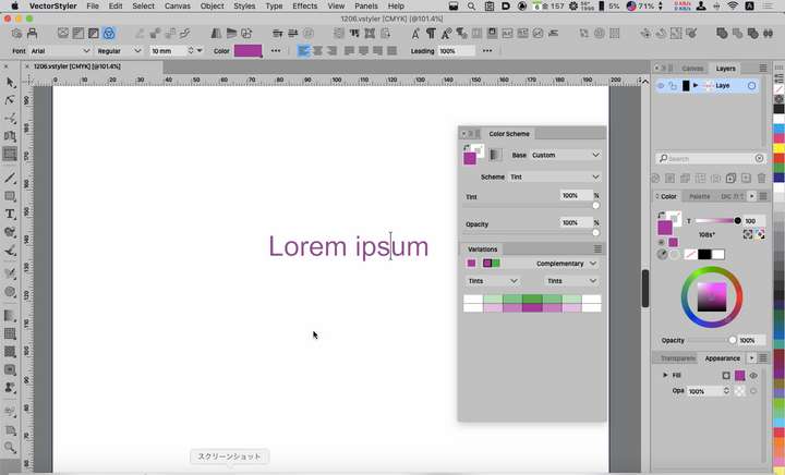

        @861475_VctSt I opened a bug on this. The problem here is that in VS there is the text color and then there is the frame (fill or stroke) color.
        The text color is shown when the text is selected with the text editor.
        I will try to find a solution for this.

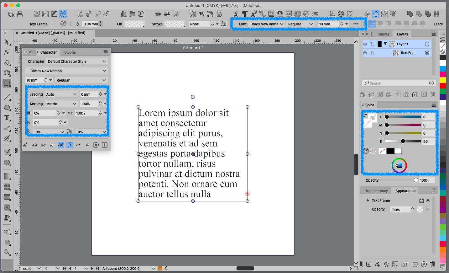

            ver.1.2.051
            Added a text color selector to the character panel.
            Words cannot express how much I appreciate this.
            I was waiting for this.

              I have a few suggestions for improvement.
              I think it would be more useful if it looks like the image.
              It would be nice if opacity has a popup and a slider.
              If you think it would be good, please consider it.

                VectorStyler @861475_VctSt
                @861475_VctSt I will add the opacity.

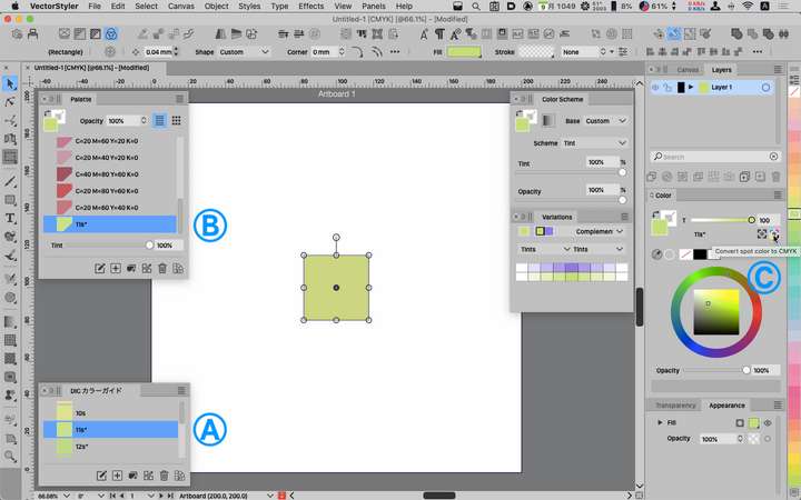

                            I am familiar with the Tint operation and prefer to use Tint even today when Opacity processing is more common.
                            (Note: I previously described it as 'screen density'.
                            Tint was placed in the same easy-to-operate position as Opacity in QuarkXpress, which I have used for many years. (See [image above].)
                            In the days of film plate making, it was common to use Tint to adjust the shading of solid colors, rather than transparency effects.
                            Designers' instructions such as, “Reduce the density of that color by about 20%,” were often heard in the field at that time.
                            However, software has evolved over time, and more and more Tint operations are not directly supported. For example, in VS, I found the functionality in the ChororTheme palette.
                            I will continue to use Tint because I am accustomed to the intuitive nature of Tint operations, but I will also use Opacity in some situations.
                              @861475_VctSt said in text color indicator:
                              Tint is available with spot or global colors.
                              • 861475_VctSt8 Offline
                                861475_VctSt @VectorStyler
                                Thanks for the advice
                                I see, it is convenient to register a spot color as a global color in the palette and use it. (A, B) Moreover, I can do CMYK conversion on the color palette. (C)
                                The concept of tint processing was an important method when film plate making was the mainstream, but in today's highly digitalized environment, the need for such processing may have diminished. The younger generation may be confused by the expression “color tint 20%. It may be more common to use transparency adjustment to dilute colors.

                                  ver. 1.2.052.
                                  The charactor palete now has a slider bar to set the opacity of the text color.
