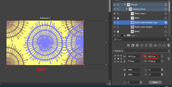

      I have a pattern design, with a tile being 1200px wide. I want to repeat the object (radial) in the corners (4 quarters). So it should be a simple offset of 600px center to center. But that is not what VS thinks.
      1. I try to recreate a design that I created as a raster before. I traced the pattern but because of tracing an already clipped design I have some minor issues causing visual lines.
      2. So I wanted to recreate the pattern as a whole, and for that I want to offset the center object such that it fills the corners. The artboard is setup with the dimensions of the original tile.

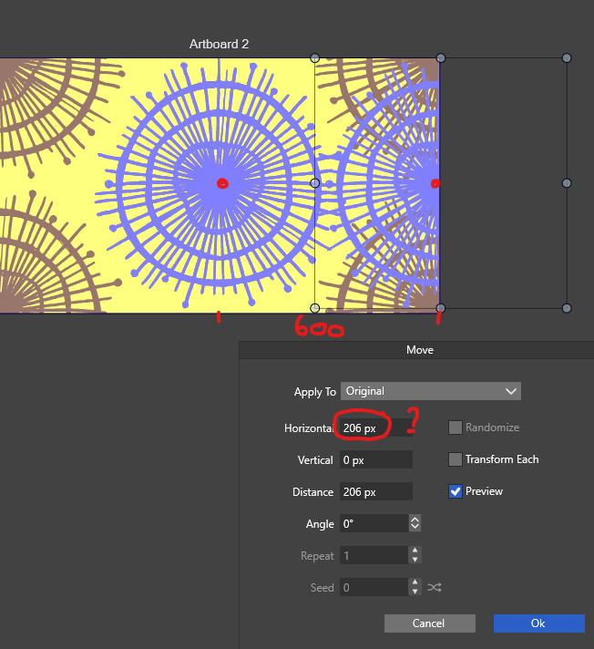

      3. I was not able to use math in the transform boxes. I assumed I could just type +600 but it replaced the dimensions completely (is this even possible? if so: how to input?)
      4. The settings in the transform panel baffle me ( I tried it with a manual copy, a clone, and a copy from both the transform > move and transform > transform panel). I know it should be 600px, but I need to input 206px to get it done.
                  In the Move view the Horizontal (and Vertical) fields are relative movements, so no need for the +600, that would only modify the current value in the field.
                  Just type the relative movement amount in this field.
                  The circled field is the Width of the selected object. The fields in the first column (left and up arrow labels) are the actual (not relative) positions. Here you can type something like +600 to add to the current position for relative movement.
