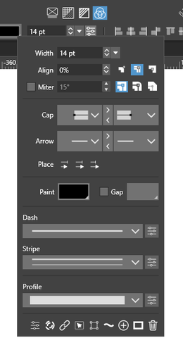

        Now apply a Stroke Stripe on that Pattern, i use a 14 point stroke width and Stripe 2 here.
        Copy/duplicate it rotate or move it a bit and combine it
        and you have the steps to create such patterns

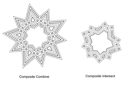

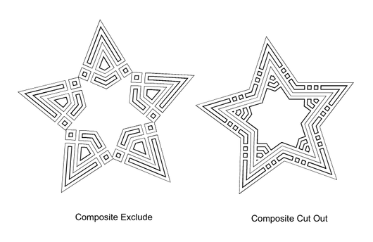

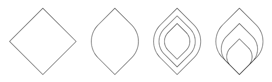

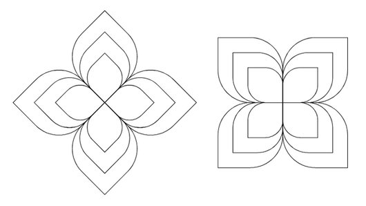

          Here some Composite Boolean Modes.

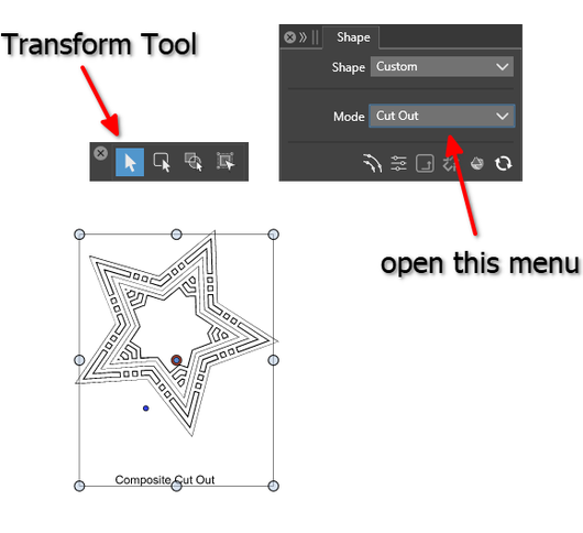

          For a easy way to switch between Composite Modes do the following:
          Open the Shape Panel
          ( Menu > Window > Shape Panel )
          Now select your Design with the “Transform Tool”
          and choose a Mode from the Pull down Menu
