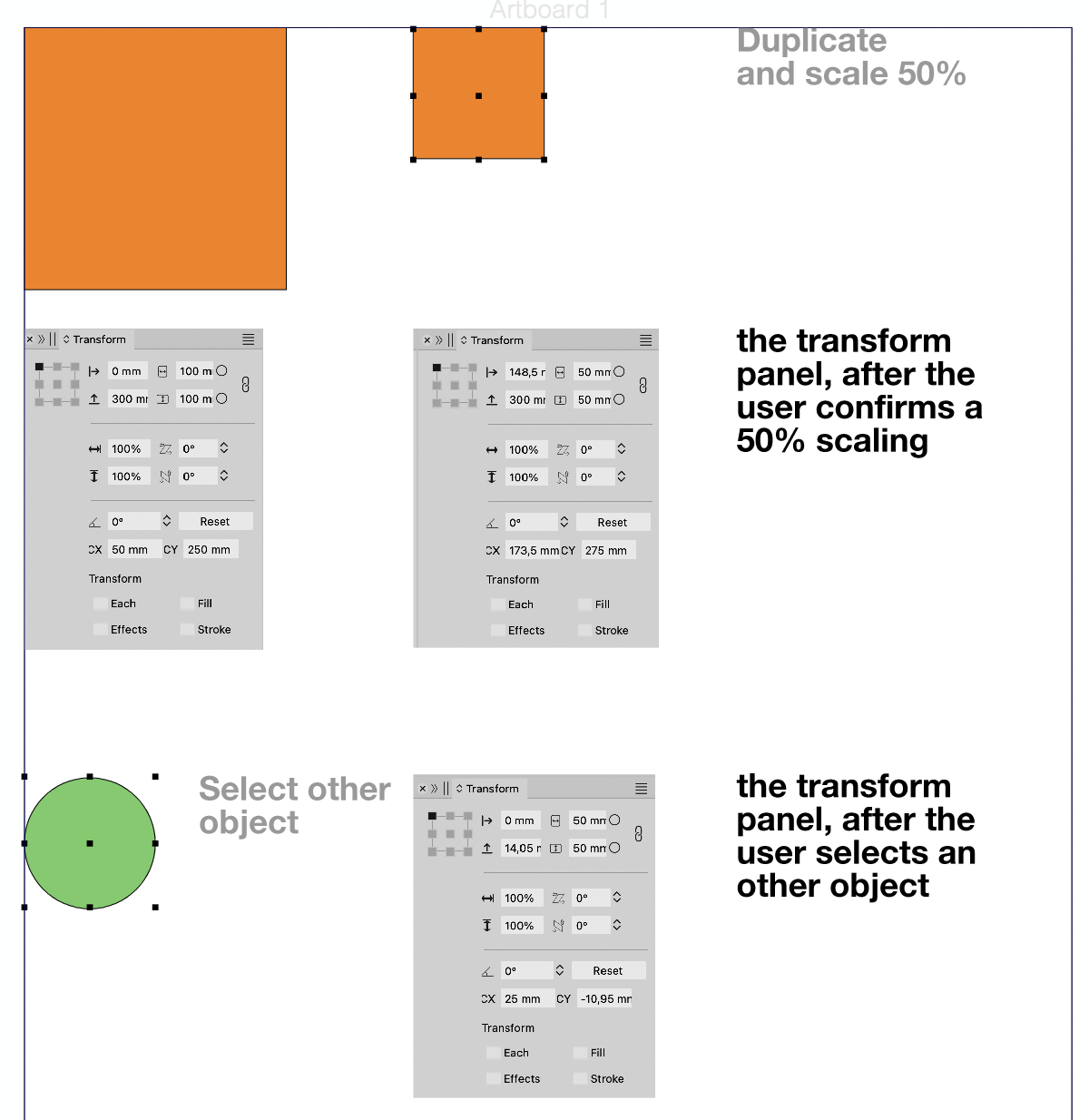

                      VectorStyler @Ayo
                      @Ayo said in Non-destructiveness vs new (visible) reality:
                      Destructive > gives new spec values ​​after transformation
                      Question: what will be shown in the transform panel, after the user confirms a 50% scaling?
                      And what is shown after the user selects an other object?
                      • AyoA Offline
                        Ayo @VectorStyler
                        This...

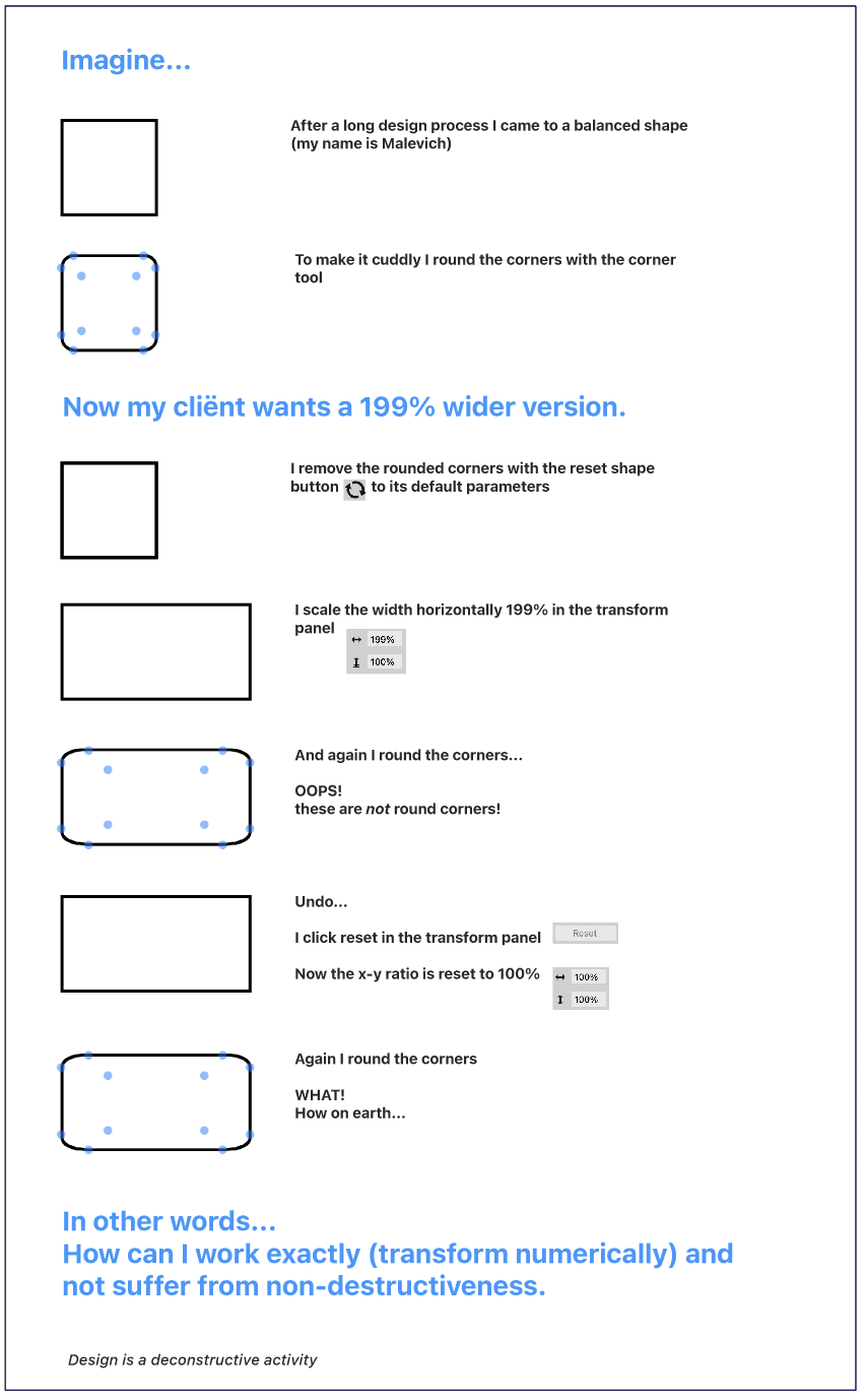

                        • AyoA Offline
                          Ayo @Ayo
                          Is there, or is it possible to create a global option that shows scaled/transformed objects and text after transformation the new (visible) specifications?
                          Another example I've come across that may illustrate my problem well ...
                            VectorStyler @Ayo
                            @Ayo In this case, you need to convert to curves first.
                            I can try to find a solution for rounding of scaled objects, but it will not work well for other than rectangular shapes.
