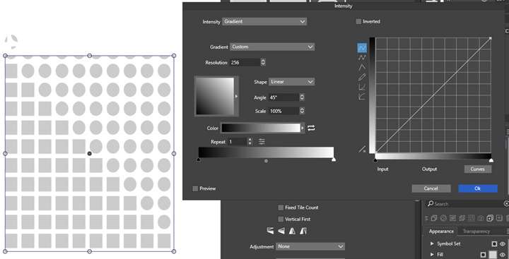

      When using gradient to select repeater symbols, the preview doesn't update and the output after closing the modal windows is not as expected (either all symbol 1 or all symbol 2, but no variation across repeater scope)
      Here is a video to illustrate : https://somup.com/cTXfQQ9w8Z
      edit : after further tests, it looks like a "sampling" issue, where the whole repeater selection switches to one or the other symbol based on luminance at one point in the repeater space instead of 512 points. Something like that
      to illustrate : https://somup.com/cTXfQr9w9f

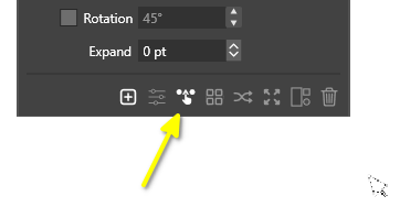

        Select your objects; they don't have to be symbols.
        Choose , " Pick selected objects as symbols in the Repeater"
        (see pic)
        and then click Edit > Selection > Gradient
        this way it was working here

          @Subpath thank you for looking into this. I could not make your suggestion work (pick selected objects), it creates repeaters within the selected objects, not using the selected objects. I probably don't get how it's supposed to work.
          However, I still believe there is an issue with gradient, regardless of the way the repeater was created (I did not use symbols in this example).
            VectorStyler @EricP
            @EricP There is a bug here, with shapeless repeaters using some of the selection methods. I will try to fix this ASAP.

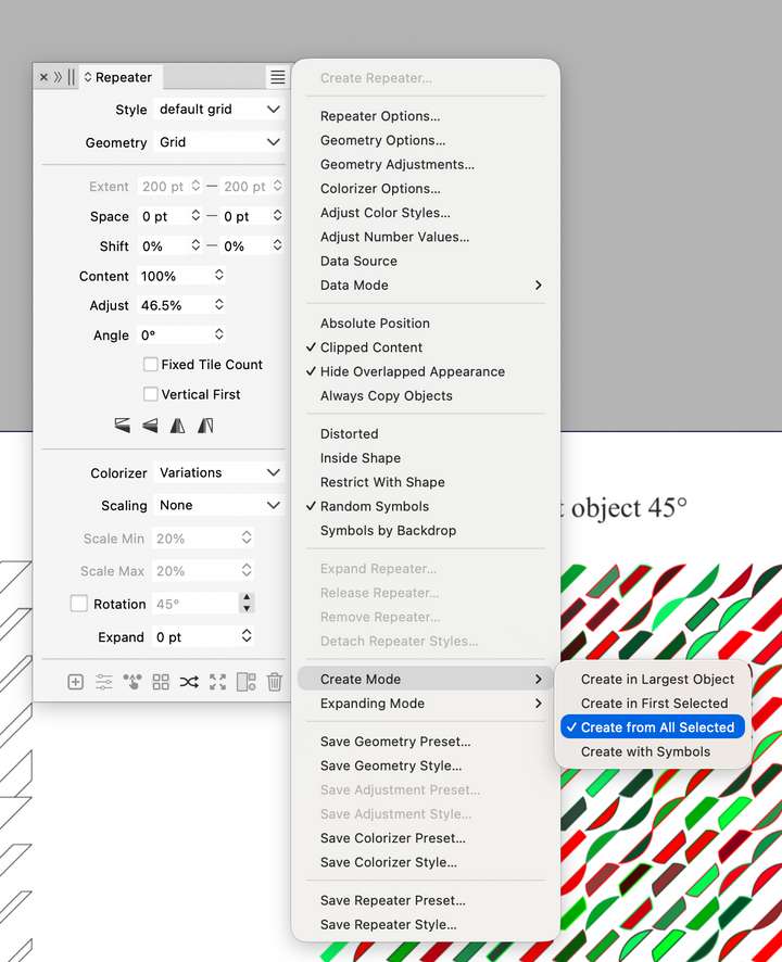

                • E Offline
                  EricP
                  @Subpath there is an option in repeater to define how it's created.
                  Your repeater is probably set up to create in largest object or first selected.
                  Mine is set up to create from all selected, or create with symbols. In that case, the repeater is said to be "shapeless" and uses a rectangular shape that you can change dimensions with Extent parameters
                  S 1 Reply Last reply Reply Quote 3
