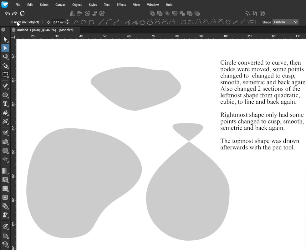

                @VectorStyler Hey I managed to reproduce the same issue again. I wrote a note of the steps I took in this gif.
                The lower shapes were just circles that i converted to curves. The top shape was drawn directly with the pen tool.
                The lower shapes, I just moved some nodes with the node tool. Changed some node types and segment types. That's all. Afterward, selecting multiple points of the top shape and bottom shape doesn't work as before.
                Sure, clicking and dragging allows selecting nodes from both shapes with the node tool but this does not fix the bug - which is that node handes from two different shapes can not be moved together as before. It also makes precise shape editing a bit annoying, fiddly. 0_1763239650638_Node selection bug.vstyler
