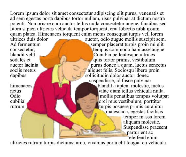

Hi! Im testing the ways i can wrap text around images with transparency. Transparency of PNG are not used currently in VS as an empty space where text can flow, so, i thought that if i embed inside a SVG file a PNG with a vector silhouette in the background, it can be easier to wrap text around it.

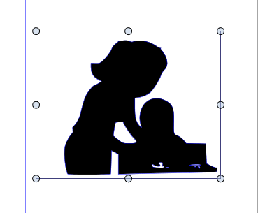

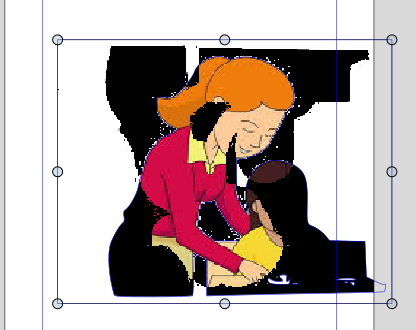

But when i import the SVG with a bitmap with transparency embedded, and the vector silhouette behind, VS shows it in a weird way. I mean, only the behind silhouette is displayed, and then, if i resize the imported SVG beyond artboard, the bitmap embedded is displayed in weird way.
Here is the original SVG, as is shown in explorer thumbnail:
If you drag it to VS, it is displayed this way:
And when you resize it beyond Artboard boundaries, it becomes this:

@marce I think you need to remove the fill of clipping mask to let the bitmap be visible
Here's a quick example : 0_1765728225834_text wrap.vstyler
