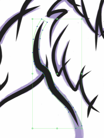

                I tried again now with expand strokes, convert to curves, and then I hit "ungroup all" that seems to have separated the bend from the expanded stroke - but the bend itself is still there - just detached from the expanded strokes. Is there another step in the process or do I need to select one of them (since they are empty stroke and empty fill) and then hit "select same as" and then delete manually?

                    @vectoradmin Jumping back over to this one again.... I still run into issues getting rid of the taper bends after expanding. I'm sure part of it is my using pressure sensitivity in my lies, etc. is there a way to select>similar and have an option listed in there that would target the selection of all the taper bends no longer needed in the design now that it's been expanded and converted to fills? This might be a great way to solve this problem - one added step to select them all and then delete. The bend tapers are interesting because when one is selected, it acts like a stroke complete with nodes... but in the fill and stroke indicators squares, it shows as no fill and no stroke - I tried to grab one currently and select all similar fill and stroke, and it did not select them. As a test I made a no stroke and no fill shape and then duplicated it and did the select>similar fill and stroke and it grabbed all of the copies I had made...
                    Couldn't this be a potential solution with the no stroke, no fill leftover taper guides?
                      @Boldline I think additional Select -> Similar or Select -> Attribute options might help. For example there could be an option to select objects with similar effect types (like bend in this case), or to select all objects that contain a certain effect.
