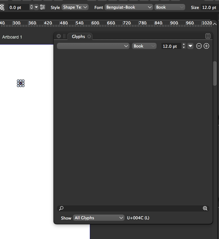

      Even if all the characters in the text box are just regular letters? I was really trying to use benguiat font...

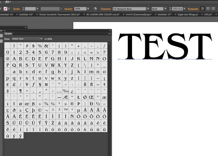

      When I did the same text in illustrator, it didn't give me any problems
        @Boldline In this case AI will show the missing character boxes, and then revert to the previous font.

            @vectoradmin I'm not 100% sure where this copy of Benguiat originated from, from an old file, another program or from the internet somewhere, so it might not be the "best" file? When I open the glyphs panel in VS and go to Benguiat, nothing shows in that panel and the text box shrinks to a single small square.
            When I switch over to Illustrator, open the glyphs panel there, go to the same font, Benguiat, I can see the entire font listed and I can use it without issue.
            You had said, "Some fonts (like Waseem) do not have the glyphs for the characters in the text. If you select the font in the Glyphs panel, you can see the list of available glyphs." Why would the glyphs show for Benguiat in Illustrator, but not in VS?
            You had also mentioned "In this case AI will show the missing character boxes, and then revert to the previous font." But in Illustrator with the example of Benguiat, there are no substitutions occurring that I can see.

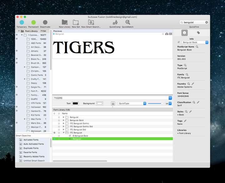

                  I dont think it's installed in my computer's system.
                  I use a font manager to turn on and off fonts

                    Looks like it is indeed a Type 1
                      @Boldline A quick workaround is to use VS Font Manager (Text -> Font Manager) to add a new font collection from a folder.
                      The fonts do not have to be installed in this way.
                      Fonts added from a folder are listed in separate collections that must be selected from the upper-right corner drop down of the font list.
