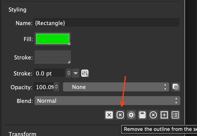

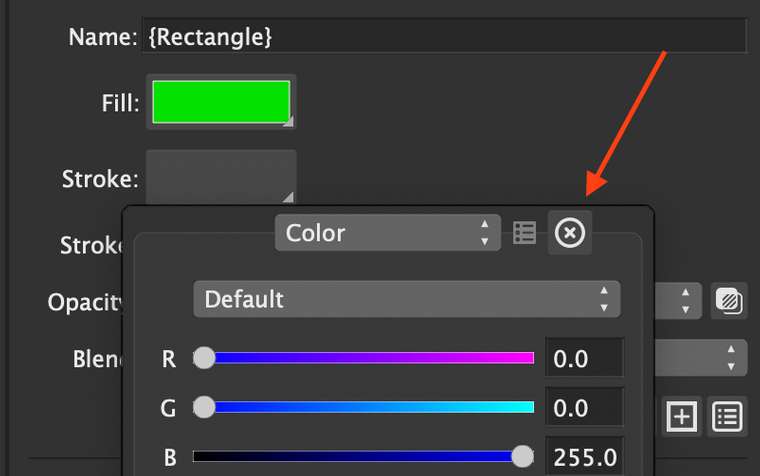

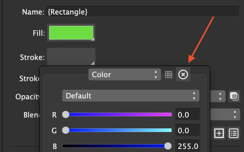

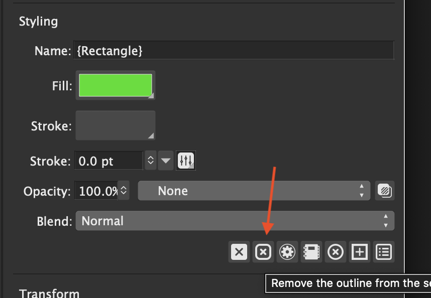

              Following up on this. V 154 allows the user to select "None" under stroke width, but the object never retains that setting. Instead it defaults back to "Hairline". This is a problem since the numeric field still shows 0.0
                About the stroke after selecting None: could not replicate this, maybe there are some other conditions.
                Could you check the content of the Appearance panel? does it contain a Stroke after selecting None ?
