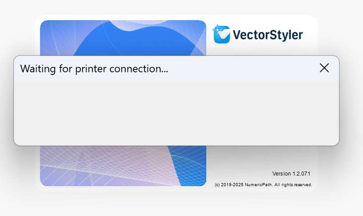

First, whenever I launch the app, I get the following message:
It stays on screen without VS responding for about a minute after it goes aways and the app finally launches.The error is probably related to the fact that I currently use the app on a laptop and off the office so the default WiFi printer connection is not available. But it seems to stay even if I set up a virtual printer as the default, probably because VS still remembers the last physical connection and tries to reconnect to that.

@Arde This could be caused by loading the last used printer options at startup.
Try printing with an other printer and change the last used printer.
