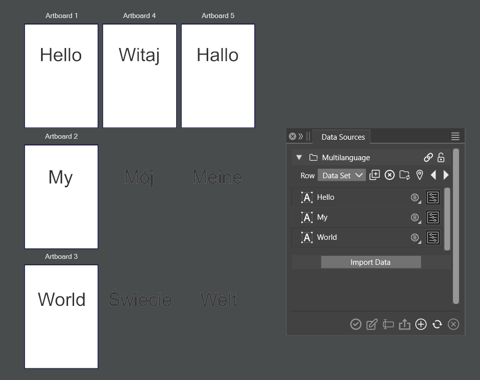

I tried to construct artboard matrices using data sources. It seems that artboards are only created in the first row:

@Harry The problem here is that only a single artboard can be turned into a grid on a canvas.

This feature would be beneficial, for example, when producing brochures/books in several languages at once by entering text in a CSV file.
