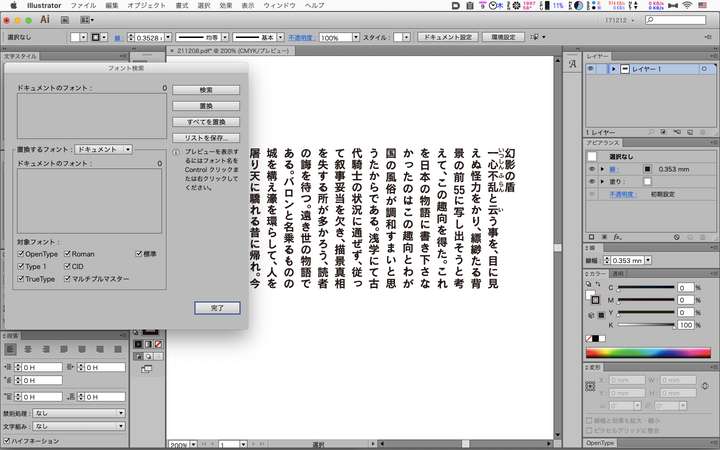

                  I don't have that problem in my environment, nor have I been able to reproduce it.
                  I have opened it in Acrobat and Illustrator.
                  The problem doesn't occur because all the shapes that VS exports are pathified.
                  (However, I have another problem where I can't embed a subset without pathing it.)
                  Acrobat
                  Illustrator

                    @861475_VctSt It could depend on the font used.
                    Have you tried Yu Gothic?
                    Acrobat can't open a pdf KozGo or Noto Sans used on Windows.
