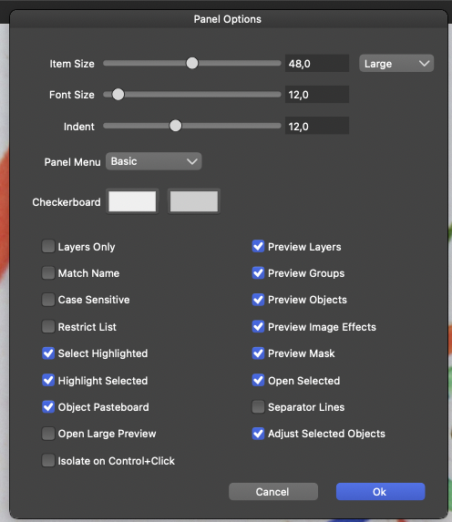

                        Issue is back - but probably related to this combo of settings:
                        De-selecting "Adjust Selected Objects" mitigates the issue.
                        🍏 macOS Sequoia Apple Silicon
