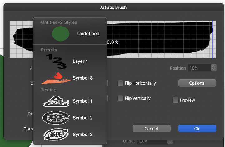

          • there is an "Artistic Brush Content" and other brush content roles (use main menu, or Object Options to select these for now).
          • when such a role assigned to an object, the object will show up in the Artistic Brush options view Content drop down.
          • an existing brush can be edited (brush style panel -> button next to the brush drop down), and another content selected.
          • in this case the original object will stay linked.
          • deleting the object will empty the brush.
