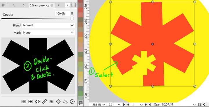

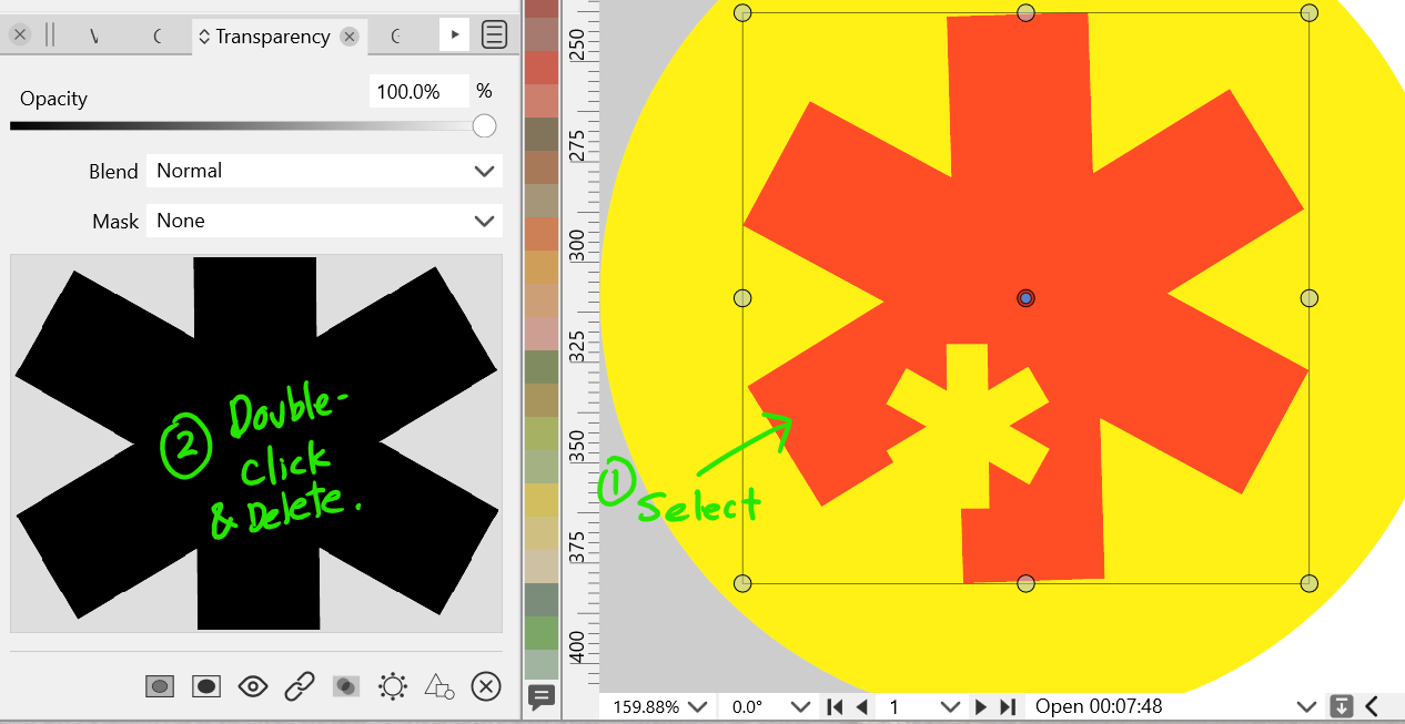

I am using VS 1.1.034 on a Win11 computer and I came across this unexpected behaviour.- I created a red asterisk shape and in the Transparency Panel I chose a "Drawing" mask in the Mask dropdown and created a black asterisk shape, using escape to leave the Isolation Mode.
 - I went under the Mask drop down again and switched the mask to "None".
 - With the red asterisk selected, in the Transparency Panel, double-click on the black asterisk in the Transparency Preview.
 - VS enters Isolation Mode. Delete the black asterisk in the main view.
VS does not let me select anything any more. I can switch tools, but the tools don't work. Saving still works, so you can try my attached .Vstyler file and see if you get the same results.

I can confirm that, after deleting the black asterisk, if I double-click on the canvas, everything works again. Good to know that method.One of the problems is that the interface does not tell me that I am still in isolation mode. Normally it would have that horizonal information bar, under the horizontal ruler, containing the "Object Isolation Mode" text to let the user know.
Perhaps, in the interests of user interface friendliness, there could be a way to let users know the interface is still in Isolation Mode?
And, as you pointed out, fix the Mask drop-down to display "Drawing" instead of "None" when it is still in "Drawing" mode.Thanks again for your help!
