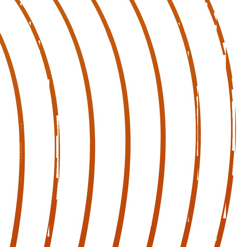

I was just playing with the blend tool and it was fine until I changed the shape of the gradient. I got then many weird artefacts.!

@PatrickM Yes, this is probably related to the mesh gradient rendering issue with GPU.If the Preferences -> Performance -> Compute Engine is set to Software, it should render correctly.
Are these gradients along the stroke, or just regular gradient fills?
@VectorStyler It is set to 'Software'. Issues with 'along' and 'across'.

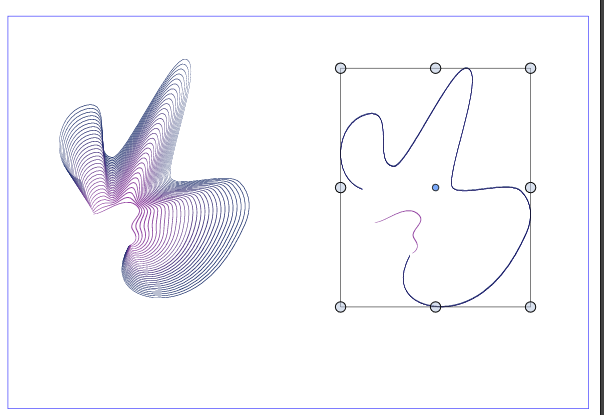

@VectorStyler when I duplicated a blended form (alt + click & drag) and press 'shift' to keep the duplicated form horizontally, the blend(ing) disappeared.
Edit: the history panel is empty
@PatrickM I tried to replicate this, with a basic blend case, but seems to be working here.
If you press Command+R (Refresh) does the blend reappear?
And is the blend in a group or just the 3 objects (source / blend / target)?
@VectorStyler It happens when you release Alt (sometimes Shift) while still pressing the left mouse button
@VectorStyler I've sent you the file after the issue occurred by email
@PatrickM Got it!

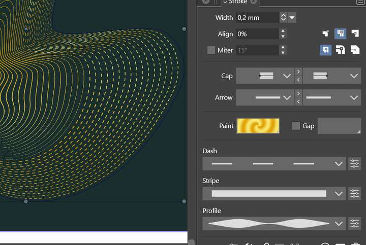

@VectorStyler I was "playing" with blending, stroke shape etc. Why do I get only a few dashed blended strokes/lines when I select "dash" in the stroke panel ? see below:
@PatrickM I think the dash attribute is not blending correctly. I think this might be a bug.

The gradient artifacts should be solved now.

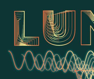

I did this years ago in Adobe Illustrator :
When I open the file in VS:
@PatrickM Got the file, will try to replicate it.
@PatrickM I would need the AI file to replicate this issue. The problem occurs when importing the effects from AI.
