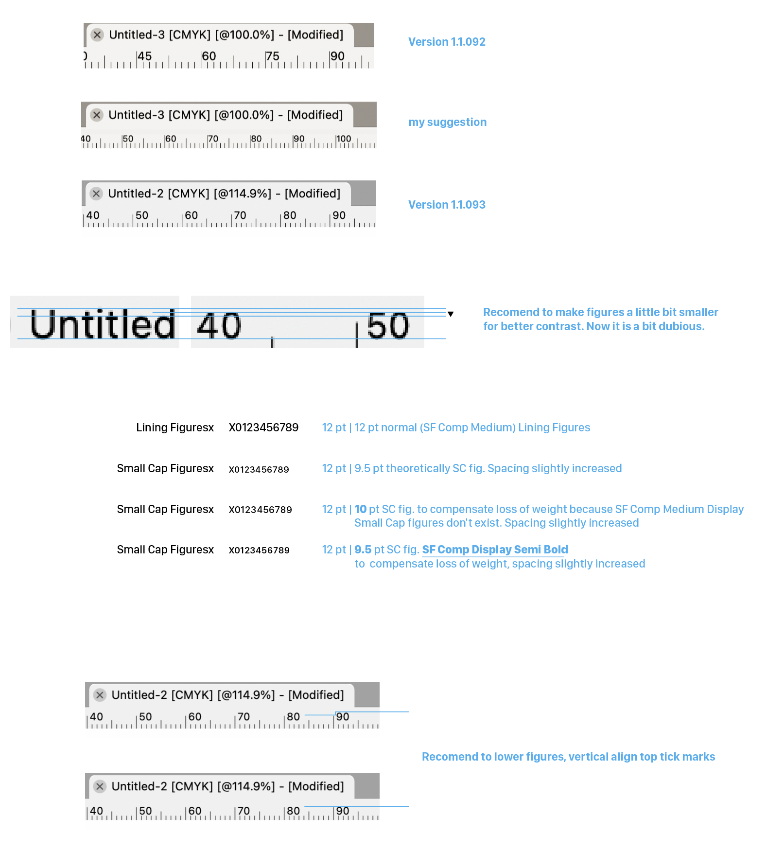

  • I noticed that the ruler has been modified in version 1.1.093. Probably because of my idea to use Small Caps Figures for the rulers.
    Almost there but have a few more comments on that.
    1. make figures a tiny little bit smaller for better contrast. Now it's a bit dubious. Illustrated also option to use different font for SC lookalike to compensate loss of weight.
    2. lower figures, vertically align top tick marks as before.
  • @Ayo I can't say I like the numbers being so close to the small tick marks, just so
    the top will be at the same level with the top tick marks.
    And while I personally wouldn't mind these to be a bit smaller, I have to ask what about
    people with poor eyesight?
    @Ayo said in On Ruler, guidelines and indicator line styles:
    Yes.
    I did hesitate a bit with the font size. It can become hard to read at smaller sizes.
    Indeed too close in the quick visual example. Example was about top lining. Long tick marks should be little longer to give more space below. All about detailing
  • @Ayo Yes, the top tick marks could be just a bit taller.

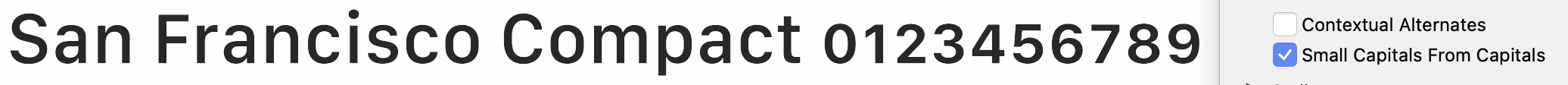

  • @Ayo said in On Ruler, guidelines and indicator line styles:
    Small Cap Figures are actually not a different font size but only a different style.
    FYI and perhaps superfluously, but I didn't know, that but SF-Compact has real drawn (not simulated) SC figures in its (rich)repertoire!
    @Ayo I will try find a way to use those for the ruler.
    The problem is that in VS the document and the UI is rendered with different engines.
    The document is rendered with VS own rendering engine, and it has all the OpenType font features.
    The UI is rendered with the host OS (MacOS or Windows) and this one does not provide access to all these OpenType features.

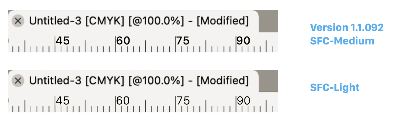

    Could also be a matter of weight to bring about some contrast. Look...
    I think even better than the SC. Matches (belong to) the tick line style!
