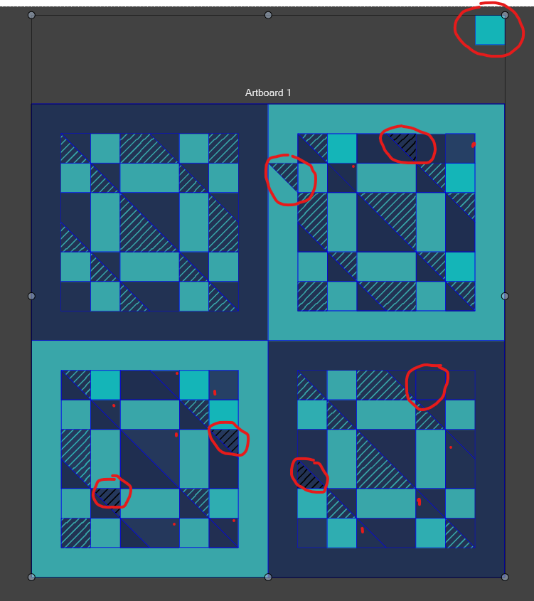

      As you know I have been experimenting a bit with recolor, using various ways to achieve this.
      I ran into quite some problems, especially where colour swaps seemed to happen randomly, and where undo resulted in a greater chaos.
      The design used is quite simple and I did not need to use these tools to achieve my goals as making clones of the tiles, and selecting by fill in this simple duo-tone design is way faster.
      Here is a video of the issues I ran into with Effects > Replace Color > Color from Palette : https://go.screenpal.com/watch/cTVOiBnfUi3
      I also had issues with Replace Color > Replace Color where undo was not always returning to previous state, and even where I opened the dialog and it changed to 'Color Harmony' and pressing cancel changed my design still. Sometimes even with part of my design being moved from their location, or new colours not existing in my palette were introduced.
      I am not sure if this has to do with designs being grouped or not, but I also tried in ungrouped state and things still randomly changed.

            Apparently I made a recording of this test too. I thought it had failed but I found it sitting in my account. Sorry for the length, it was my rudimentary attempt to show all objects in the file were ungrouped, and that there were no other colours than the few shown. As the filter shows more colours than there should be, I cancelled, and then partial recolour happened anyways and the pattern broke. Just skip a bit to the end (1:15).
