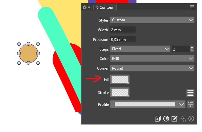

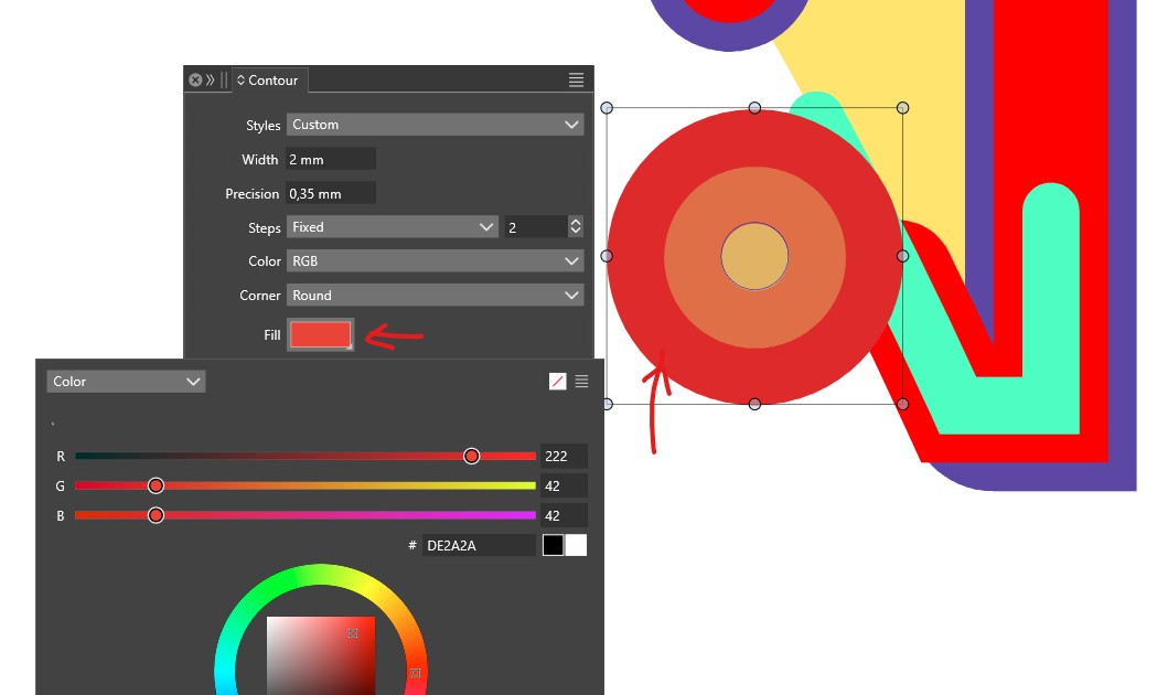

I wanted to colour a contour:
But, no way to keep the colour:

@B-Vs-V I replicated both of these issues (contour and stroke color).
The problem is with the UI scaling causing the color/fill popups to apply the color at the wrong moment.
As a workaround, set the UI scaling factor in Settings back to 100% for now.
(I know, this is a weird bug, but nevertheless it is a bug).

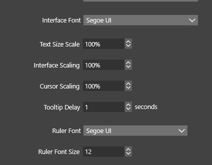

@VectorStyler Well, is it this ?:
I don't think I ever modified this UI scaling & the newly reinstalled VS presents the same bugs (?)
@B-Vs-V It was 98% in the settings file you sent.
@B-Vs-V The display scaling from Windows might cause the same event, fix will be in the next build.
@VectorStyler ok, then I did it by accident & never noticed. Indeed I did adjust a display scaling in W11.

I've also noted that when text and interface scaling is set, for example to 110%, the contour stroke or fill colour selector pop-out panel increases size each time you select it until it is enormous!
